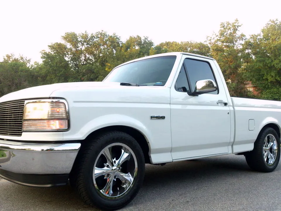

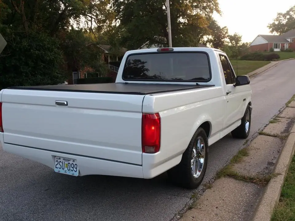

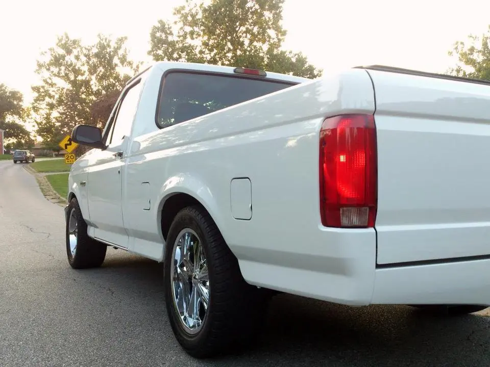

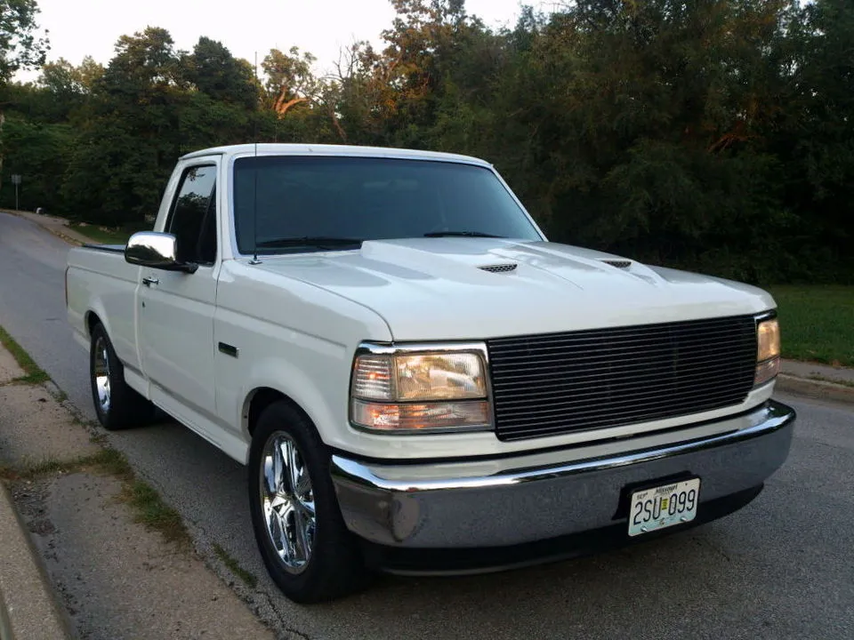

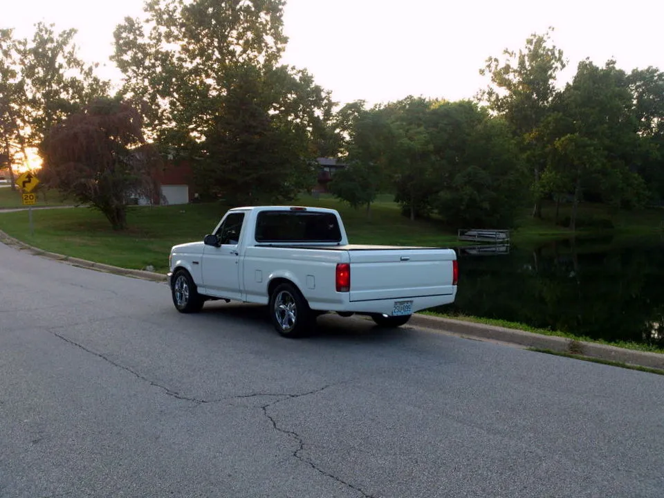

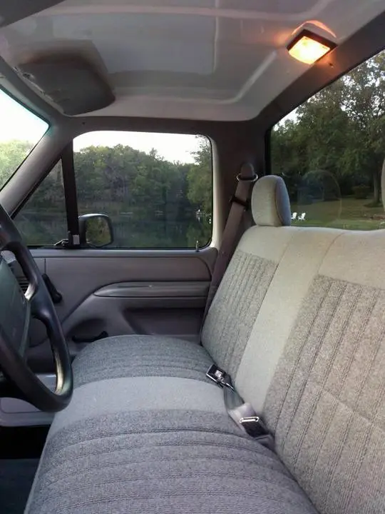

  16. Just for fun, here is the truck you've been helpin me figure out =P
    Any Ford fan should appreciate :flag:
  17. Nice clean ride
  18. Thanks! One would be hard pressed to find a cleaner 92-96 truck anywhere.
    I guess until I get it tuned there's nothing else I need to know. Thanks for your help :nice:
