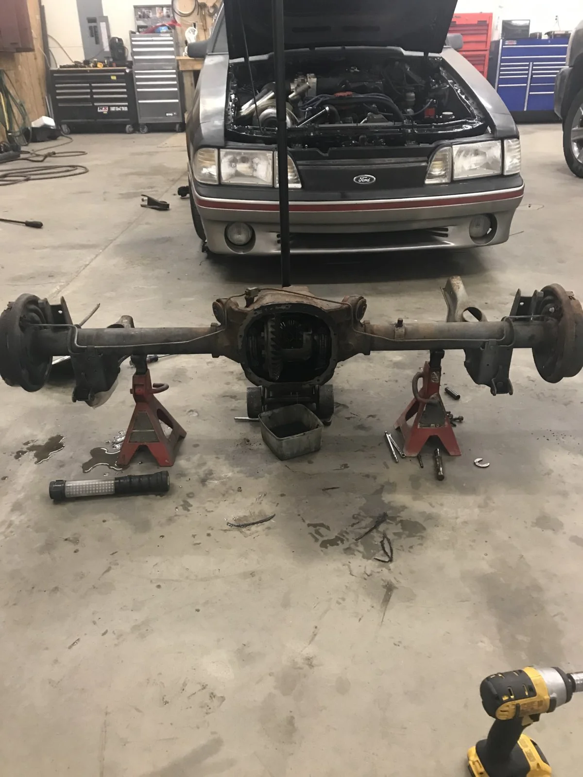

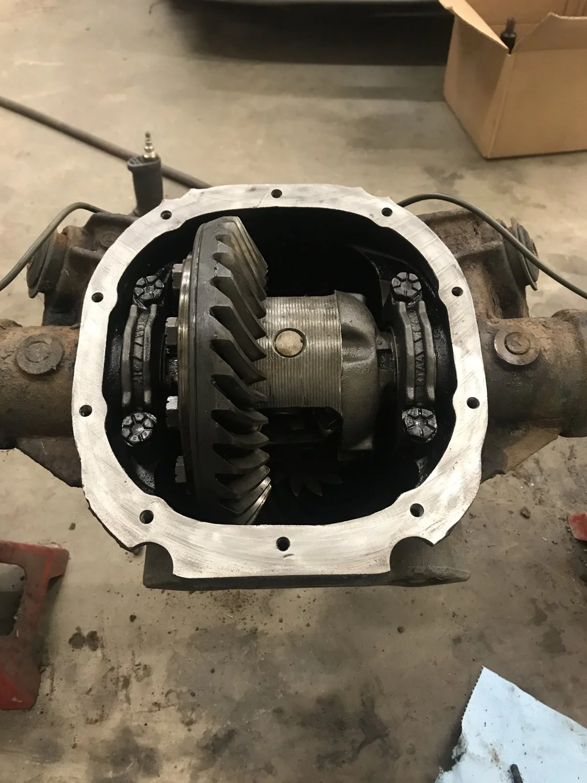

That sucks. In case you ever buy another rear end in the future, you can verify the gear ratio in the absence of a tag and without removing the cover by turning the axles and counting how many revolutions the pinion and/or driveshaft make for one revolution of the axles.
