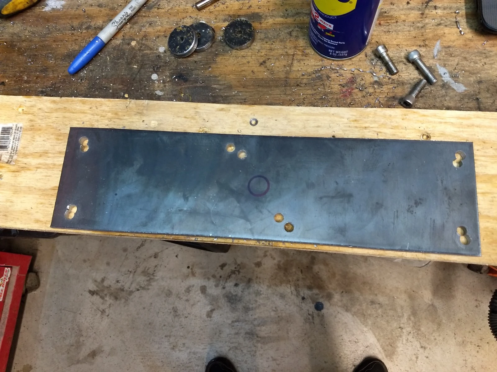

I do have pics of a related project, I wanted one of these, but in case you guys haven't figured out, I'm cheap, err uh, frugal.
SVE SBF EFI Engine Lift Plate 5.0L/5.8L - LMR.com

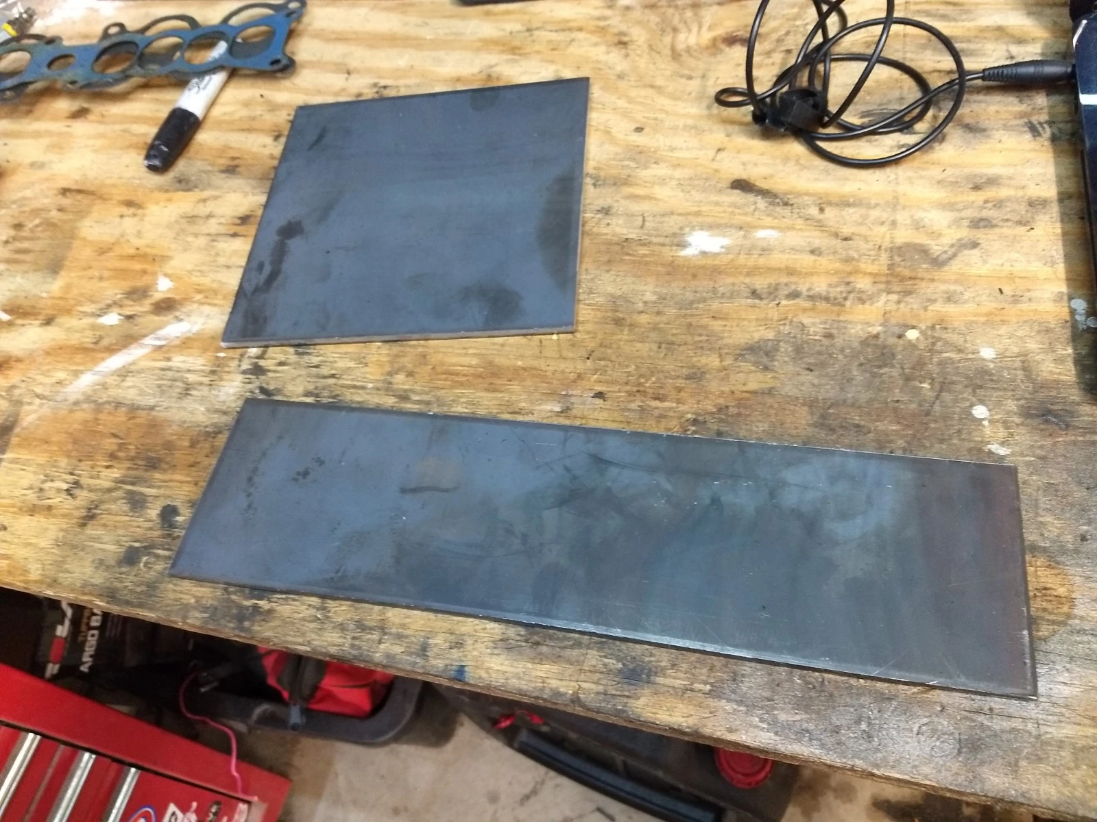

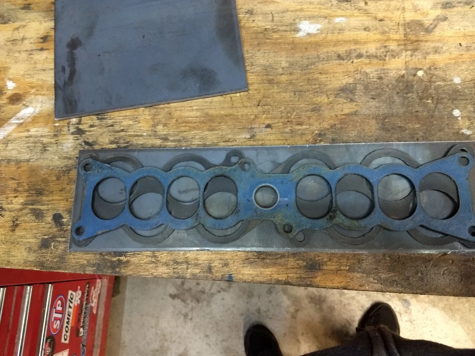

So I decided to see what I could come up with. I made a trip to a fab shop around the corner from my house, they have always hooked me up with steel for cheap, especially if it comes out of their scrap pile, so $5 got me this, they even cut it to the measurements I asked for.
I wanted it to fit the H.O. intake and the Explorer intake

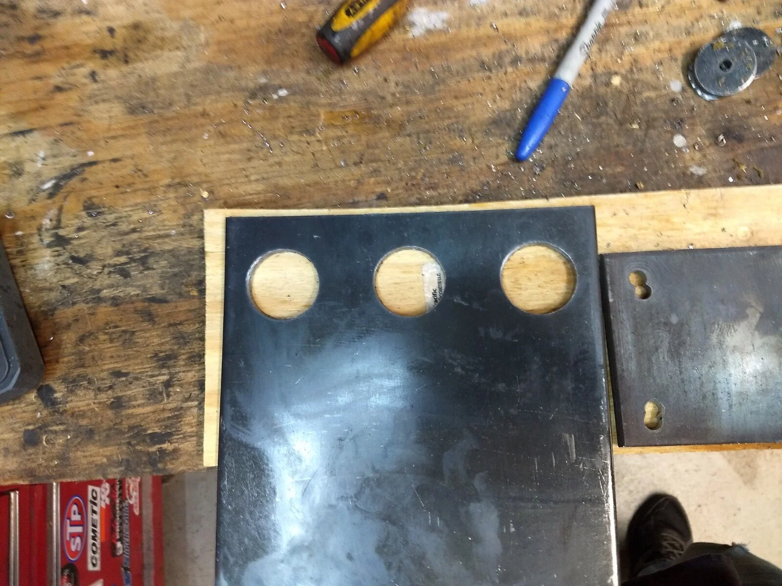

I cut these with a 1 1/2 hole saw

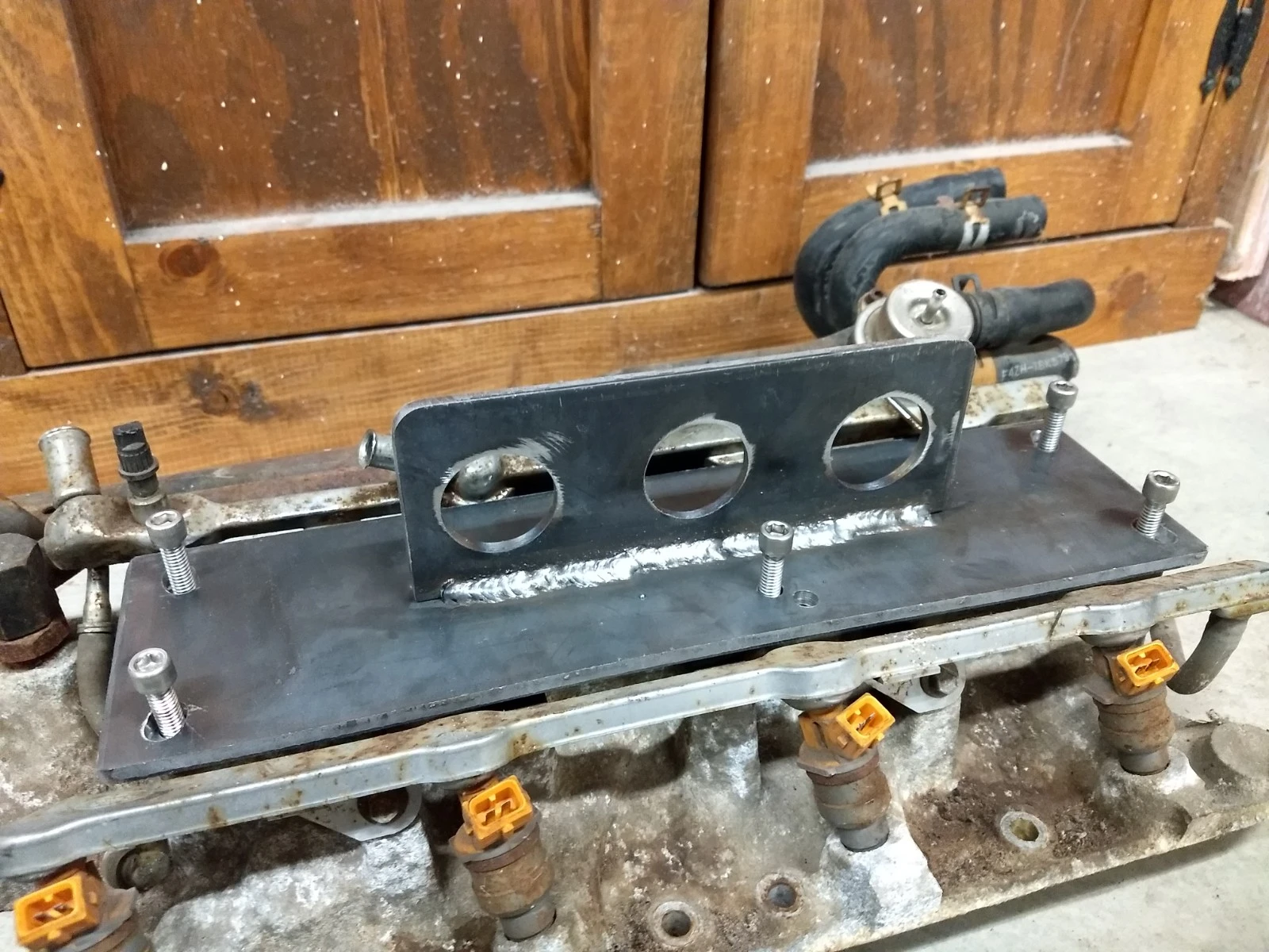

All welded up
Test fit, I did go buy better bolts and washers. It worked great, and for only $5 and an hour or so of my time, I'm happy with it.

The one he linked from LMR is $69.99. $42 is still a lot considering how cheaply one could be made even if one bought the steel rather than getting cheaper scrap. Maybe I should make one.
