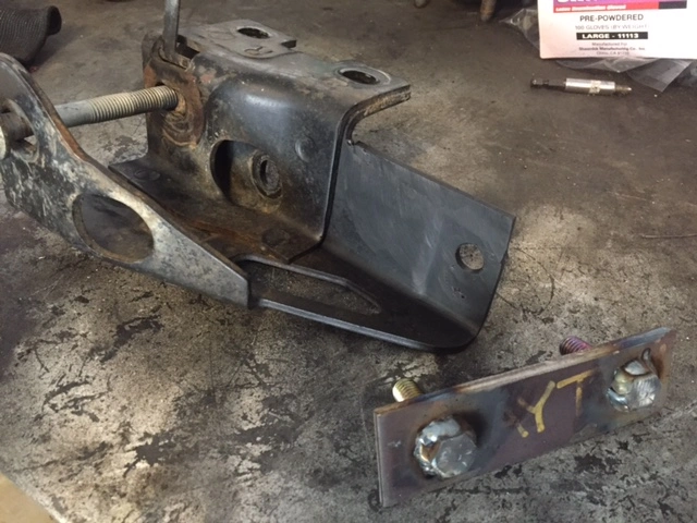

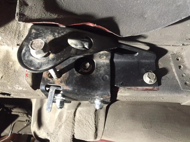

I installed the subframe front mount points with nothing in it, left the rear hanging, then assembled it that way and swung the rear up into place. I had such a hard time getting the front in I didn't want to screw with it again.
