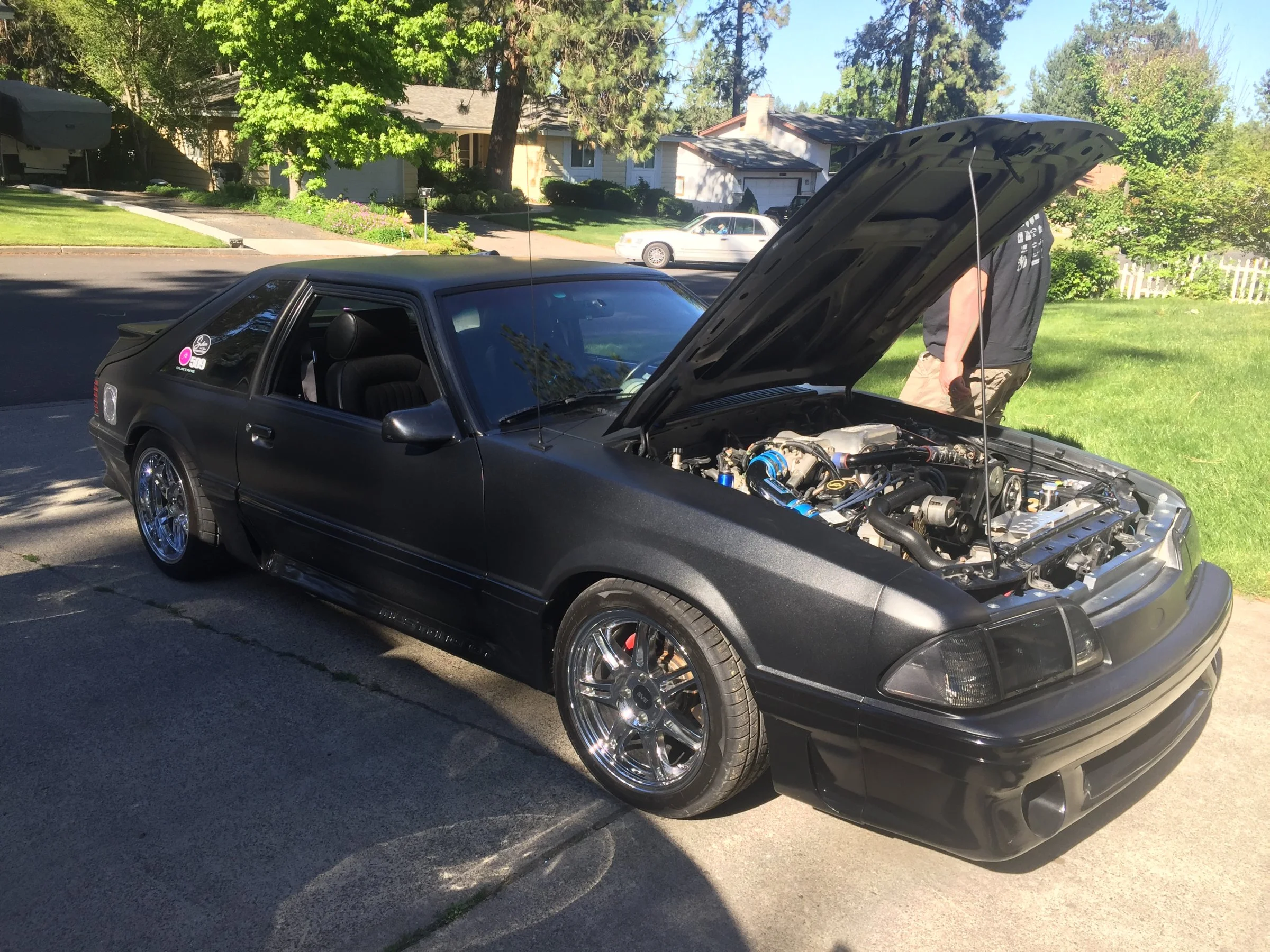

I really really don't think it's a HG, although with boost it's always on your mind because it's one of your worst fears.
Every Head Gasket I've blown, I knew I blew it, there was no question. The car got hot, smoked, loss in oil pressure, funny noises, or a combination of these things happened. I'm sure it's a coolant hose, water pump gasket, or something to that nature.
ETA: I shall pray to the FoxBody gods that everything is ok!
Appears your car turned into the Hulk and you forgot to take it out when it had to take a leak.
That appears to be a hose decided to let loose. If it was a head gasket it would be a milky/oily mess on the floor.
Looks green to me....positive thoughts.
I vote heater hose :nice:

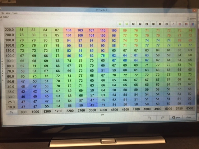

Just got back from my very needed and very enjoyable vacation in my old home town of San Diego. It was nice to see my old friends and family and catch a few waves. Now it's back to my baby, my 5.0 :D Since my dyno tune was right before I hit the road on vacation I didn't have much time to really think about my experience with Holland Performance and the tuning session. During my vacation and a over 3,000 miles of driving I'm left feeling disappointed and lucky my car didn't blow up. If it wasn't for Steve @a91what for putting in some safety in my tune for pulling timing based on manifold air temperature I'm sure my engine would have died from this guy. The tuner never took a data log, never checked IAT's, never accounted that in to his tune. He kept adding timing while the PIMP was pulling it!! My tune is still pig rich when boost hits at 2,200 rpms with a 7.7 AFR that finally gets to 11.8-12.2 at 4,400+ rpms and then holds steady. I know the numbers improved greatly on the dyno from start to finish but I left with a surging idle (too lean at idle 16+), super rich at cruising (12.2 AFR), and decel is rich too. I'm having to clean it all up after handing him a bunch of cash.
The car runs great when the IAT's are low and the car pulls frickin hard. Spins the tires just by rolling in to 2nd gear with less than half throttle. Since I don't trust this performance shop nor any other around here I will self install meth injection and hope that Steve can help with re-tuning in boost.
Here is my VE table
Hmmm 've table is top heavy.... meaning it has to many blocks above 4500 rpm. You spend the least amount of time up there. Send me the tune and I will help clean it up. Sorry you had a bad experience

True, he expanded the table to include that for some reason. Also, you see how much fuel there is at 2,200 to 2,700 rpms above 100 load? I get super rich from a steep increase in fuel until I get to the 70's at 4,600 rpms where my AFR finally gets to target.

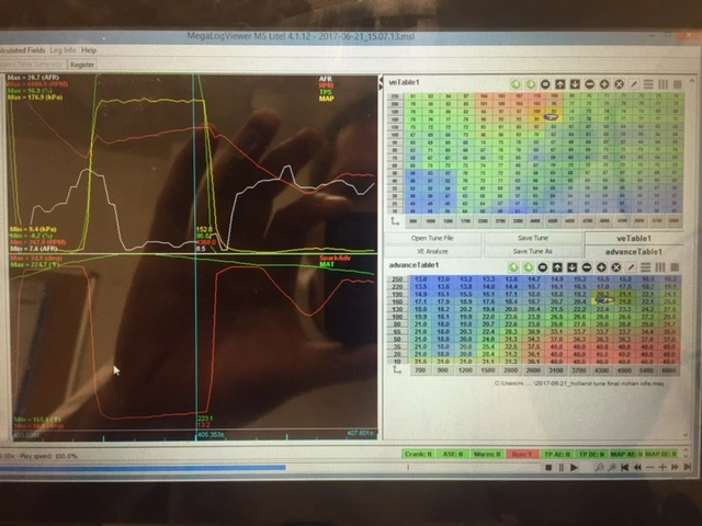

Here's what I'm talking about for those that know how to read a data log graph. The bottom graph shows timing advance in red and Manifold Air Temps (MAT) in green. Up top is AFR, TPS, boost & rpms. This WOT run my MAT was 224*, MAT based timing retard was pulling timing from 21.4 to 13.2 while hitting about 8+ psi. This is good safety built in by Steve @a91what
For those that don't know, the advancetable1 is the commanded timing and where you see the black circle is what my timing should be if my temps are OK. Since my temps are too hot the ECU pulls timing which greatly reduces HP but keeps you from killing your engine. You do not want to discard this safety feature that you build in to your tune.
