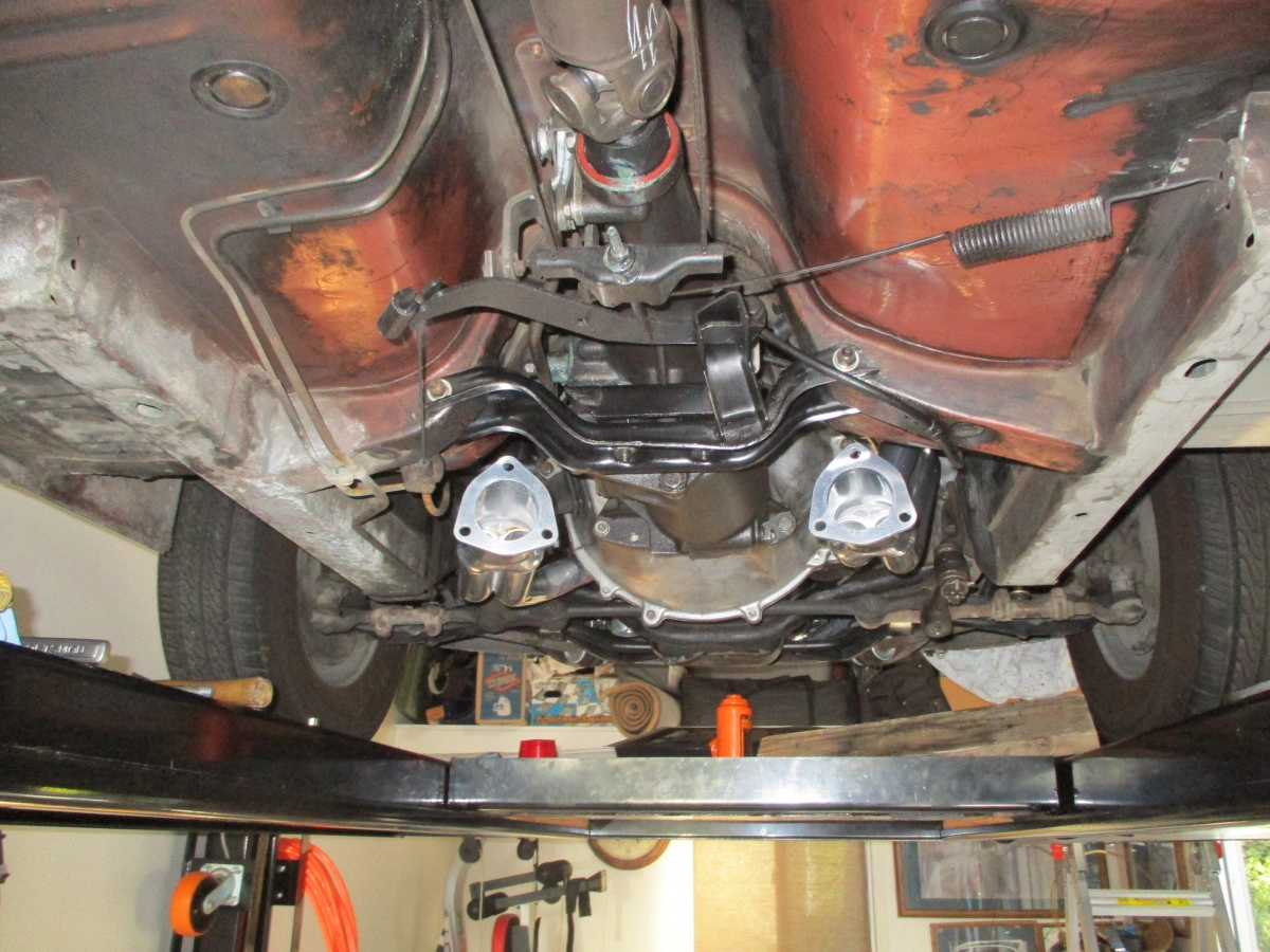

I am Not a welder by trade. I own a security consulting business because that is where I am a subject matter expert. That is what my company charges for. To help make businesses and facilities more secure. If I was a welder by trade (I do Believe you told me how your welder was a certified aircraft welder) my welds would probably be pretty and strong instead of just strong.
Now for where the headers hit the frame, that’s behind where the Heidts kit is welded to the frame. So it does not effect the headers at all. What does effect them is that your “professional” welder screwed up.
As far as the transmission crossmember, pretty sure you can’t see the crossmember in any of my photos. Guess you must have ESP? But I guess The collector being welded at a screwed up angle, which was once again done by your “professional” welder in one of RCI’s foolproof jig.

Someone sent me this photo the other day, an early Mustang with Long Tube Headers (I think the guy that sent the photo said they were Doug's Headers). Anyway, we had this discussion about how one guy complained that the collectors did not go "straight back". I tried to explain to the guy why that was true for long tube headers on an early Mustang, like the one in the photo. You can see in this photo how the transmission cross member is not very wide, and the space (the double humps) allocated for the exhaust system is near the center of the car. You can also see in this photo how wide the actual header primaries are in front of the transmission and how both the primary tubes and the collectors are canted in toward the "humps" in the cross member. If the collectors ran straight back, the exhaust would run almost next to and parallel to the sub-frame rails, and hang down much lower to the ground. The trans on this Mustang looks like a manual transmission. Manual transmissions (the Top Loader or the aftermarket 5 and 6 speeds) are quite narrow, as is the C-4 automatic, but the C-6 or the AOD are very wide. The wider the trans, the more the collectors have to aim in, especially the collector on the passenger side.

Seriously? Dude, I am So done with arguing over this. Here is a little information for you. The end of the collector would hit the transmission pan if the header would mount to the heads and clear the frame.

I'm sorry, but the fact is, you are 100% wrong on this. Almost every aftermarket header I have seen for a Mustang does not have collectors that are at symetrical angles. The quality would be more suspicious if both sides looked the same. The header is pointed to fit, and the fit from the driver's side to the passenger side is going to be different. Geoklass made it very clear why that header is at that angle. There is no possible way for someone to make a header that fits with every combination of aftermarket parts.

Did not say that. But telling my how it’s normal for a collector to be positioned that way is ridiculous. It should not be almost hitting the transmission pan because it is angled that way. And the header should not be hitting the damn frame either. Bottom line is the headers are not high quality. Hell, the true bottom line is that the old man should learn to let it go. I was Done with this nonsense. Now he throws out another “reason” why it’s not the quality of RCI, it’s someone else’s fault. And you leap on the bandwagon. Almost like you know him. Or work for him. Or some other damn reason.

All he did was show a pic of a car with headers installed and pointed out some things.

What's worse is that he's gone over it in detail and provided words and images in order to help others understand. In addition:

This is also correct. I'm no exhaust system subject matter expert but it took me less than 2 minutes to lookup and validate.
