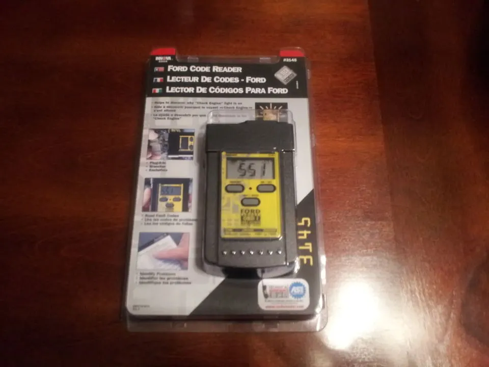

  10. Best scanner you can get IMO. Under 30 bucks too.
    Innova 3145
  11. the best scanner is a paper clip and your key, just count the flashes of the engine light, you have to do plugs wires cap rotor before you start throwing parts at it, sounds like after it warms up starts to smoke from running rich, sounds like a tune up issue
  12. Thats such a huge PITA, its hard to tell where the beeps are separated and if you loose count then you have to start all over again. The scanner is CHEAP, its Plug and Play and it spits the code right out and comes with a book with all of the error codes. So much more easy then the paper clip method.
