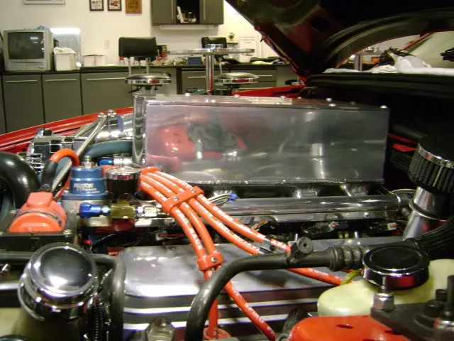

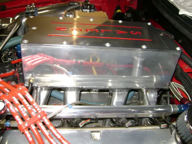

  6. I think a Hogan's Intake is what you want for your budget swap!! :rolleyes:... :D
    It's about 11" or 12" tall and with a Griggs K member spaced down 1/4" it fits under the Saleen Heat extractor hood.
    The pic's are not the best.....
  7. That looks really nice. How much does that dent the pockets for?
  8. $2800 , The intake is $2500 + 300 for the fuel rails.
    They custom make them for your engine. So you have to tell them what heads you are running, etc.
  9. Yeah, I was going to mention they were custom. I have a buddy who had one built by them and it looked completely different. Dual throttle bodies and all. Looked very exotic, but nothing I'd want to run on the street without some serious cubes or forced induction to back it up.
