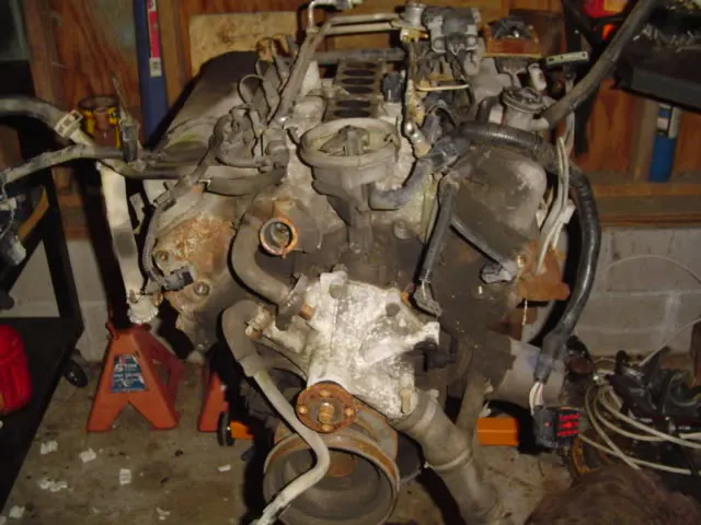

  2. for the 1000th time, I'm going to BOOST the engine. When i boost it, none of this crap will matter as much. I've seen what a S trim can do with a bone stock 5.0 longblock, so I'm pretty sure it'll give me even better results on a 351. If the 351 is making stock power, so be it. I'll live with it until I bolt up the supercharger, then I'll be right where I want to be.

    Well, my 302 and the one sitting in the shed have some miles on them. Not only that, when you push a 302 up around 500 HP, it is NOT going to be reliable anymore. Thus, the word budget goes out the window when you factor in a 3000$ S/C kit and a 2500$ top end kit. And even if you build a motor out of a stock 302 block with all the goodies, it'll still be in block splitting territory.
    And furthermore, why the hell do you guys keep saying GT40's on a 351 is useless? Why would Ford put them on there if they were that useless. And don't you agree that an S trim pumping about 13 psi down the throat of that mild 351 could be refered to as "The Big Bouncer"?
    I had great results when I supercharged my stock 302 and I'm pretty sure it'll be the same story with this 351. Even if I make the SAME exact power my 302 made, at least I know evertime I stab the accelerator that there's a very good chance my motor will live through it. My last S/C'd 302 was most definately on borrowed time with the setup I had, but it made killer power none the less, and I'll be tickled pink to have the same power again.
    And, I'd be willing to bet money that given the same setup, the S/C'd 351 will make at least a few more FT LB's of torque than the 302 did.
  7. Good point, it looks like the 351 you are putting in it has around 25k miles on it.
