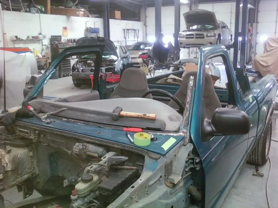

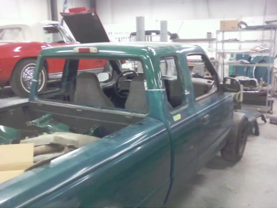

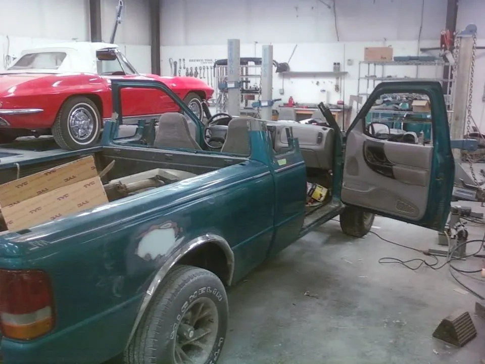

  4. got the windshield out tonight. what a PITA!!! i used a gasket scraper and an air chisel to remove it and there is glass all over my interior. good thing the dash is the only stock part that is going to be left in it
  5. At least you didn't slice yourself (assuming here) too bad while removing it. Cleaning up glass sucks, I suggest a shop vac and some beer to get the job done.

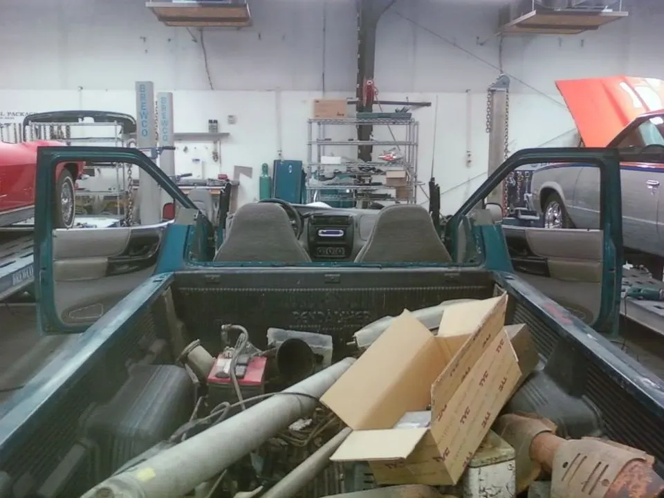

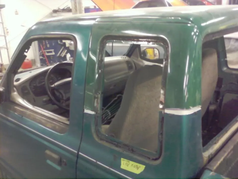

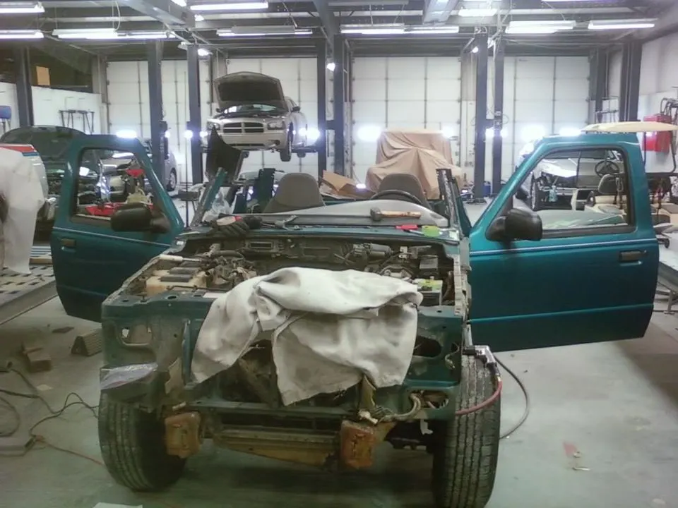

  6. made some good progress today.
  7. Nice... how bad was taking the old roof off?
  8. it was easier to take the roof off than removing the windshield. about 30 min of cutting and drilling a few spot welds and it lifted right off!

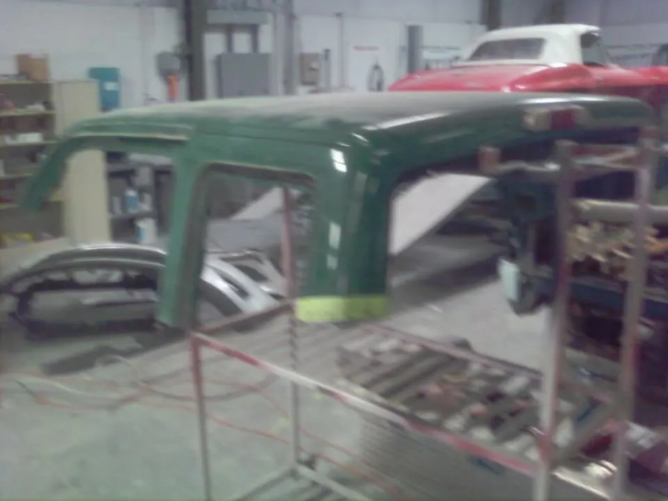

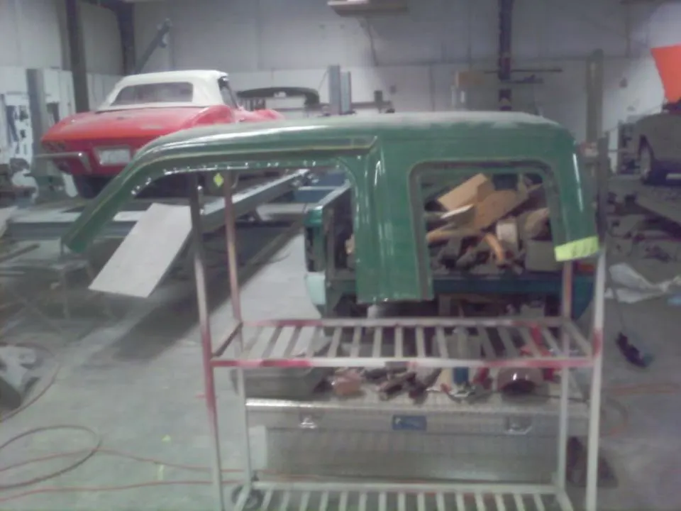

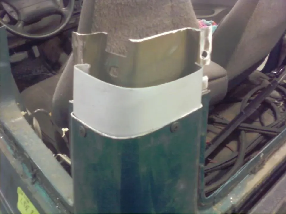

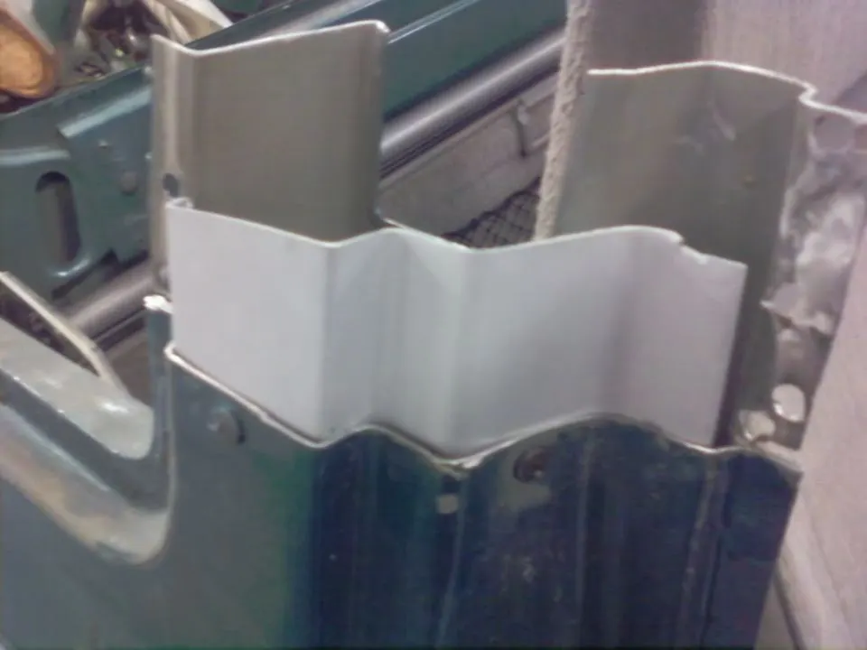

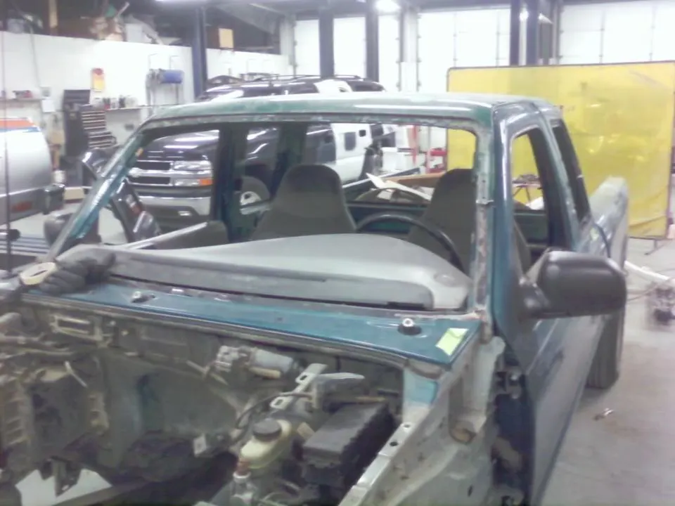

  11. more progress pics. it's looking like a truck again!
    these are the filler panels i made from part of the old roof clip.
    this way the cuts dont have to be perfect and you have something to weld to
    i still have some trimming and fitting to do before i start welding and filling everything in. hopefully i will have the top in it's correct place by the weekend
  12. Man that's a great fit for just dropping it on. I'm sure it will look as it did when it was first assembled by the time you are done. That's going to be one of the coolest Rangers around.

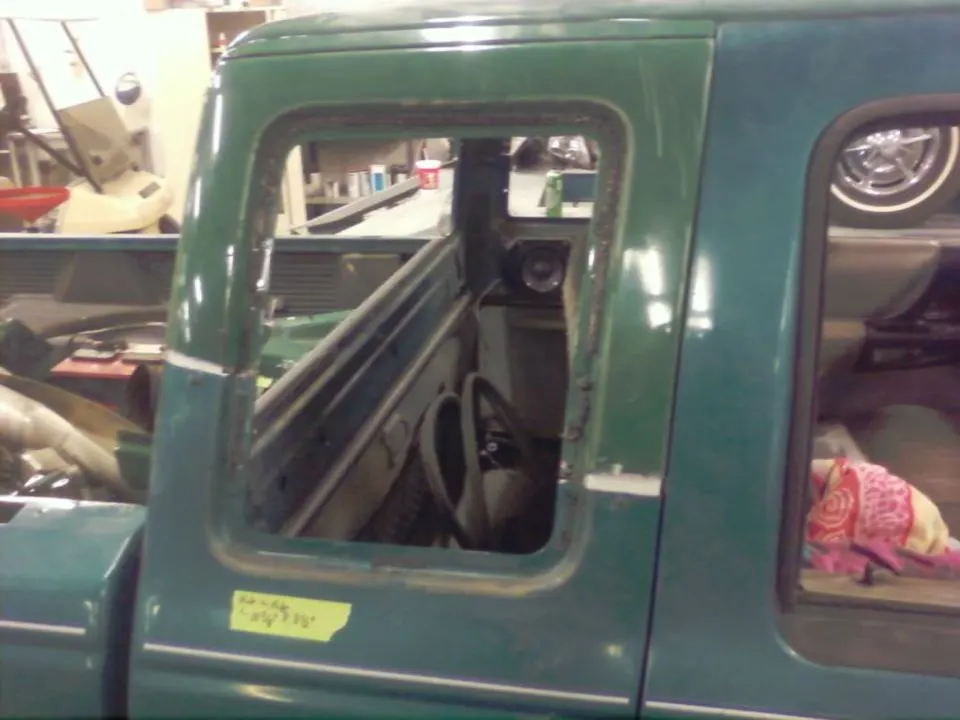

    my boss is really wanting to chop the top some. he has a glass guy coming out tomorrow to see what it would cost to get all the windows cut to fit it.
    i'm trying to decide on the paint for it now. i dont know if i want the factory color of satin black.
