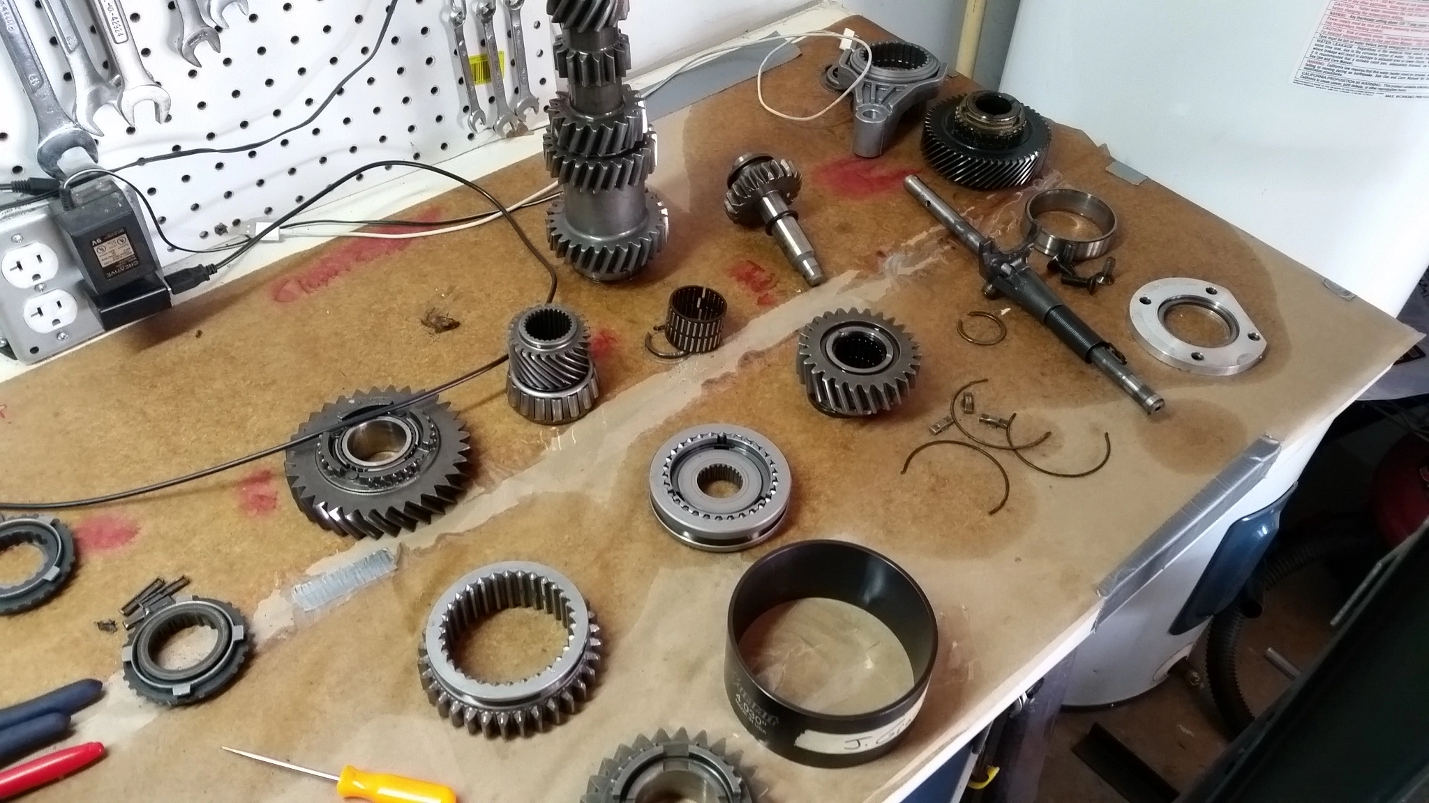

I finally got through my 1st T5 rebuild. Here is a list of parts that were replaced:
-Astro Rebuild Kit $300
-1/2 Slider $40
-3/4 Slider $80
-3/4 Billet Keys $15
-Reverse Idler Gear $35
-G Force 2nd Gear $235
-Total $705 plus fluids, etc...
Here is a link to the video I used:
View: https://youtu.be/XREsRG9Y1mU
Tools needed:
-GOOD snap ring plier's
-Dead Blow Hammer
-Bearing race remover
-Highly recommend a press (Harbor Frieght Special $115)
-Punches
-Basic tools
I watched the video a few times and the rebuild it not that difficult. I would tell anyone who is fairly mechanically inclined to not be afraid of trying this.

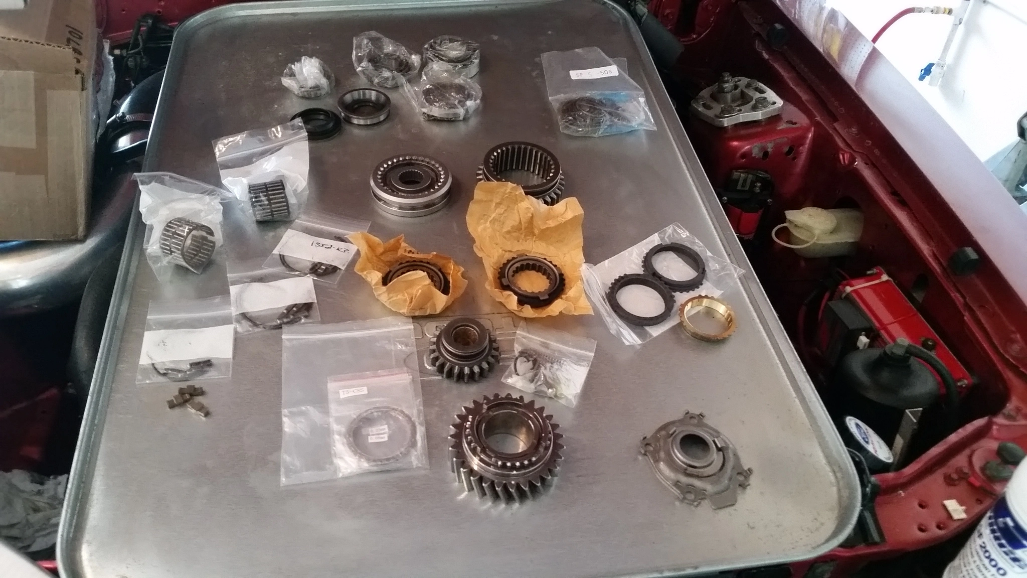

Old parts and gears
New parts

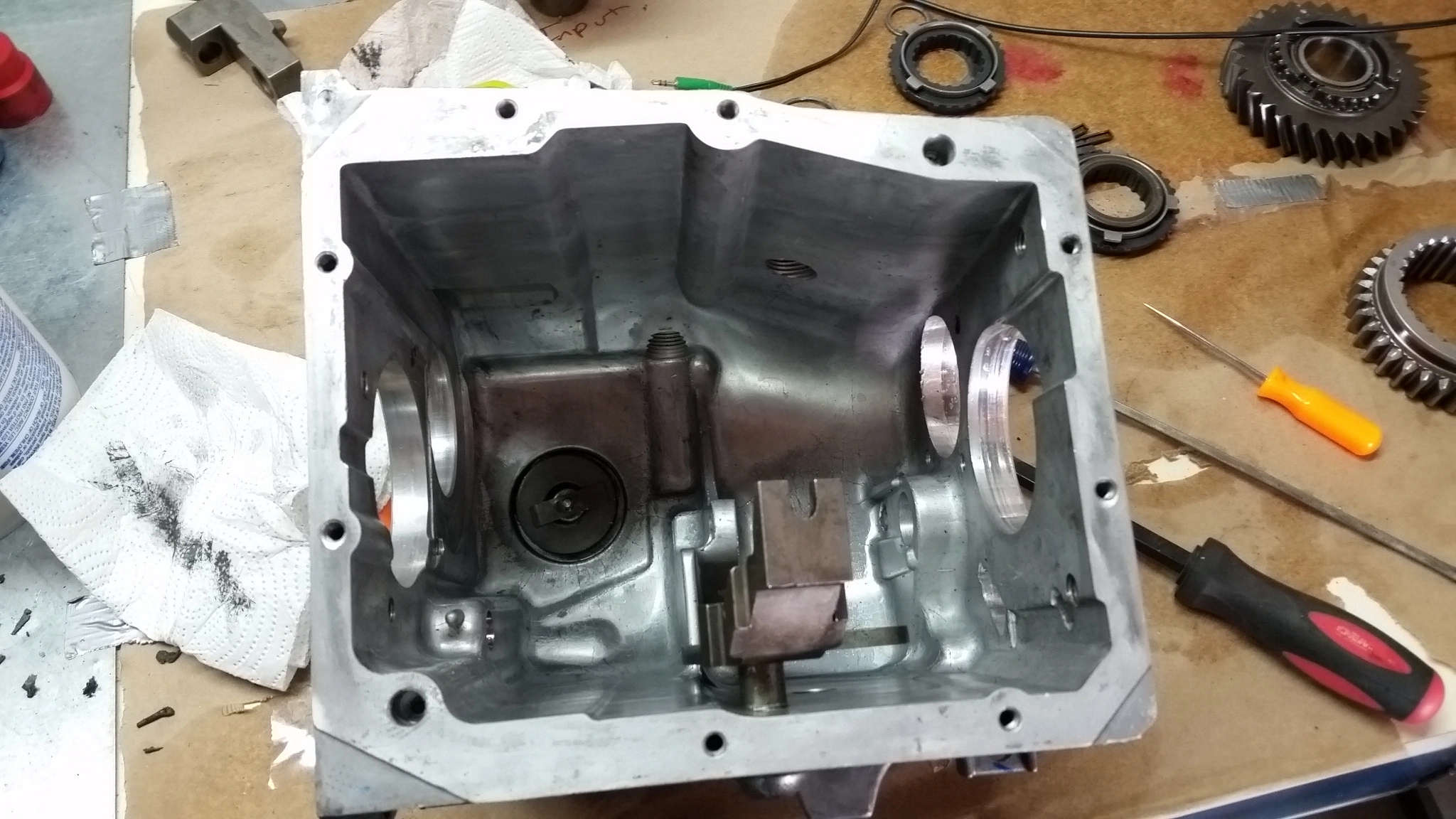

Clean case

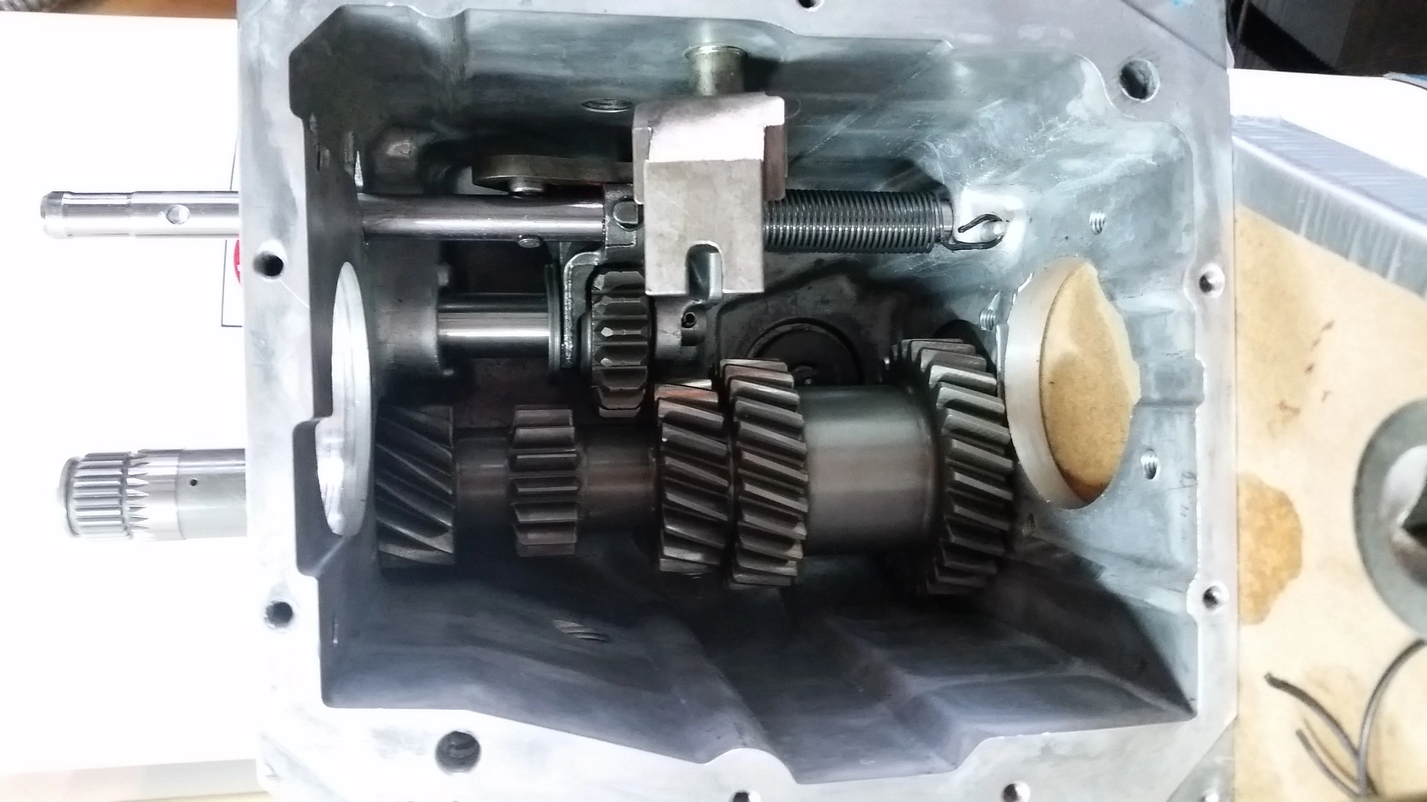

Cluster gear installed
Cluster support plate

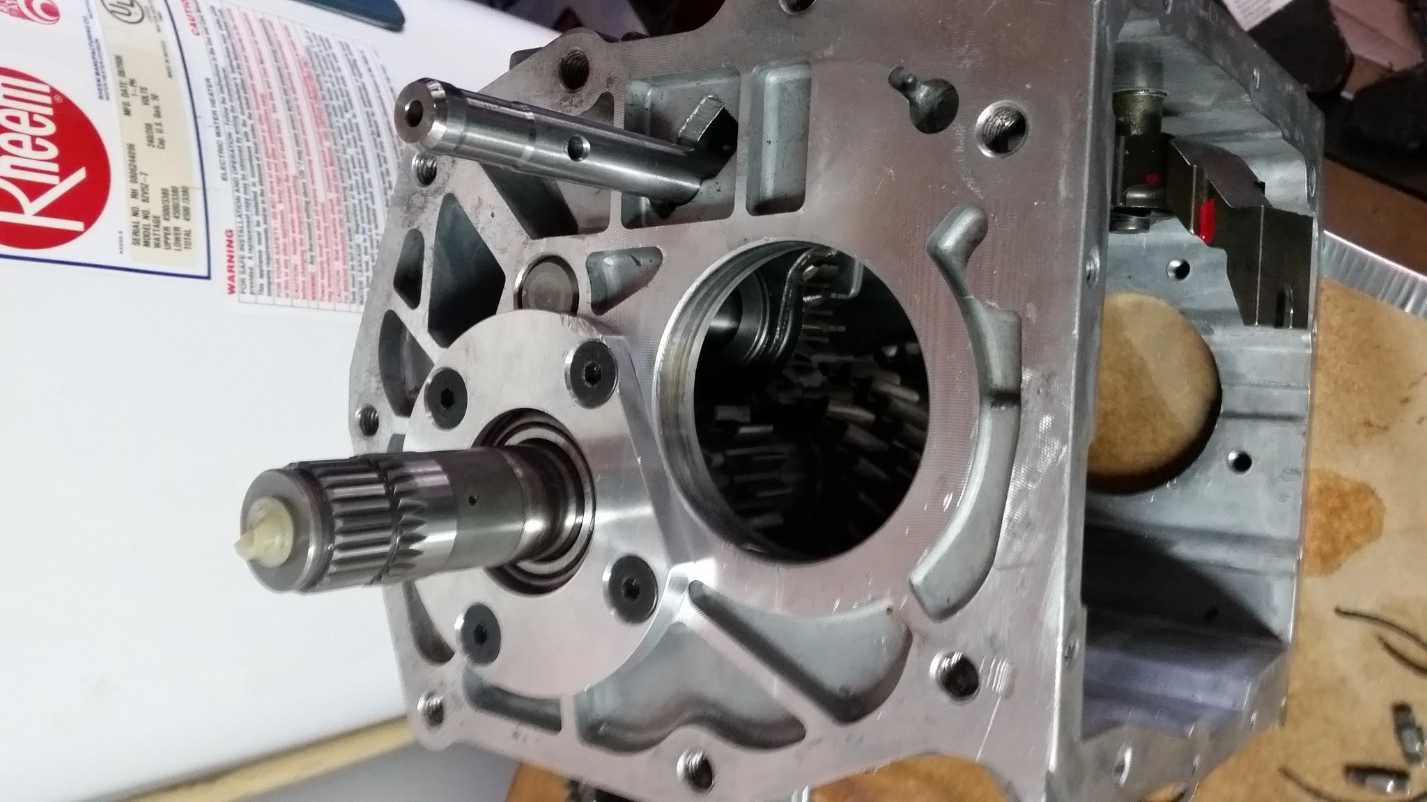

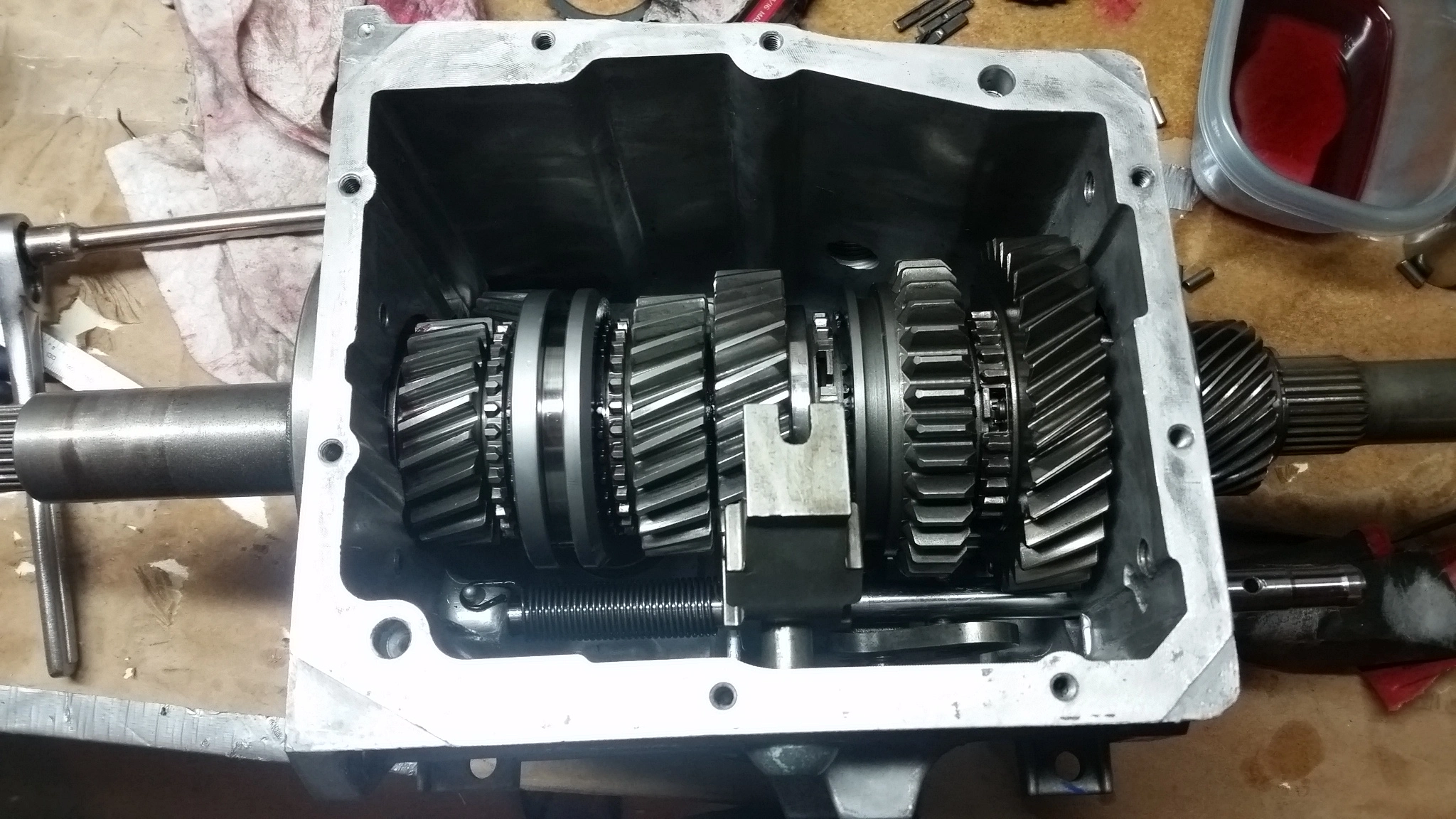

Mainshaft in
All buttoned up

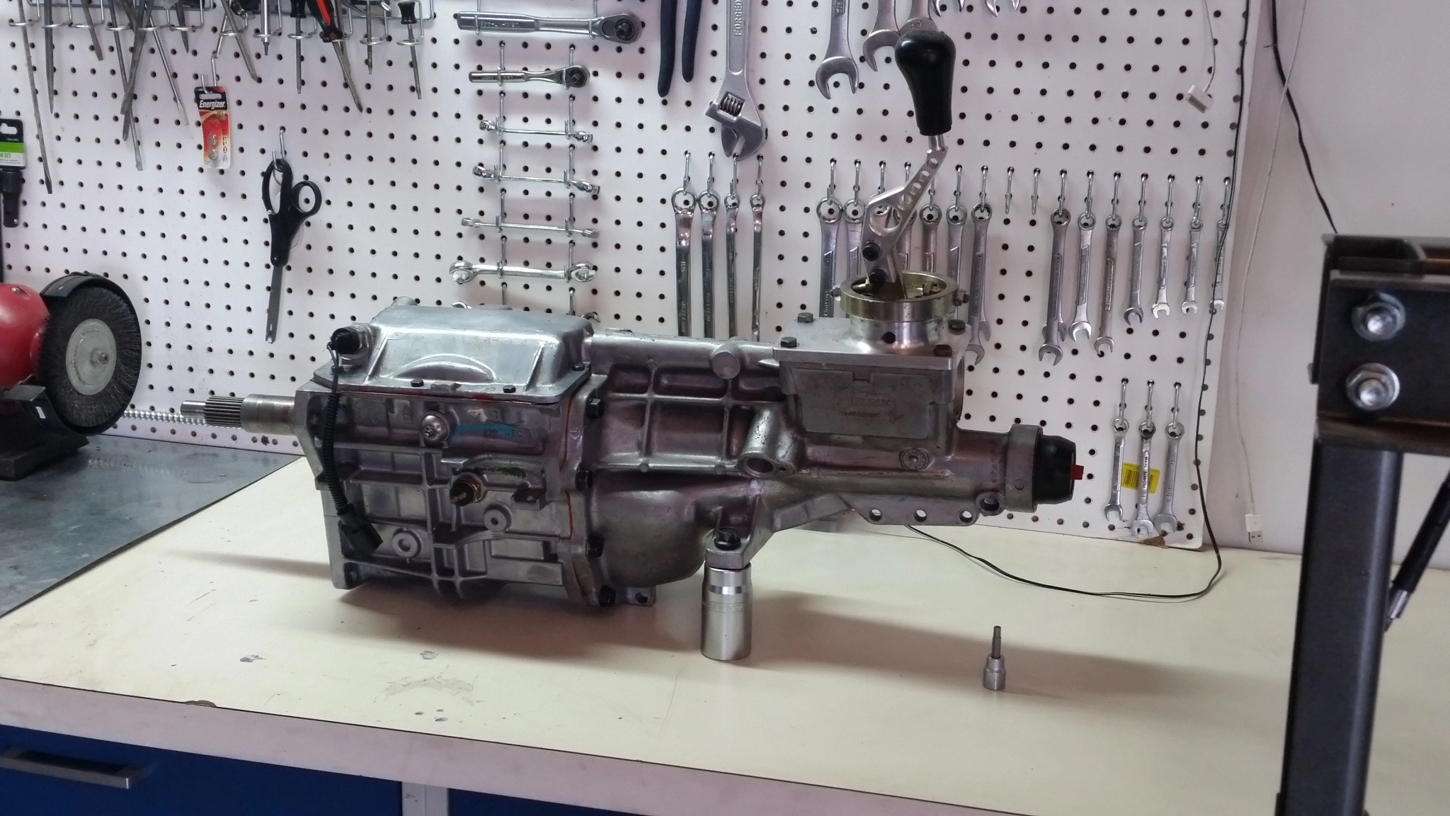

And it's for sale!
