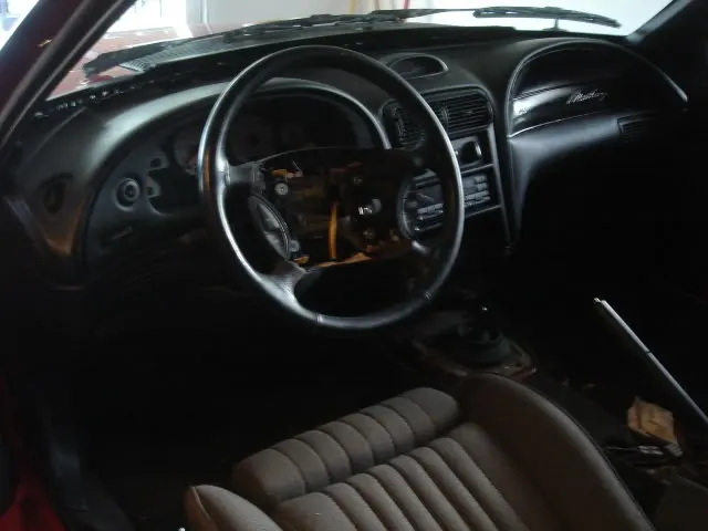

    Sorry for the poor quality pics. It was like 7:30am and the sun was beating in my garage so these look like iiishhh...Didn't get them up last night cause I was out on Woodward last night til 2am watching some fun activities. :p
    AGAIN...THE CAR IS NOT CLEANED UP. THE INTERIOR WILL GET A FULL CLEAN AND SHINE.
    Dash all buttoned up. It's in need of an Armoral. It needs some moisture put back in it. That dash I've stored here at the shop for 5 years. Got the air bag too, just not in yet.

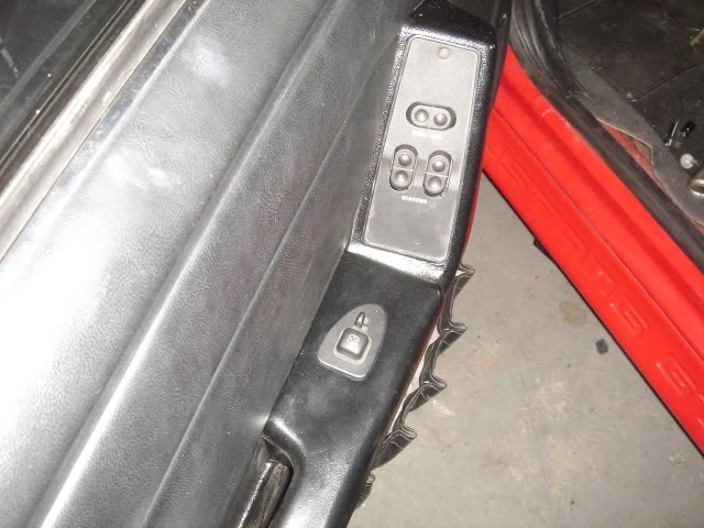

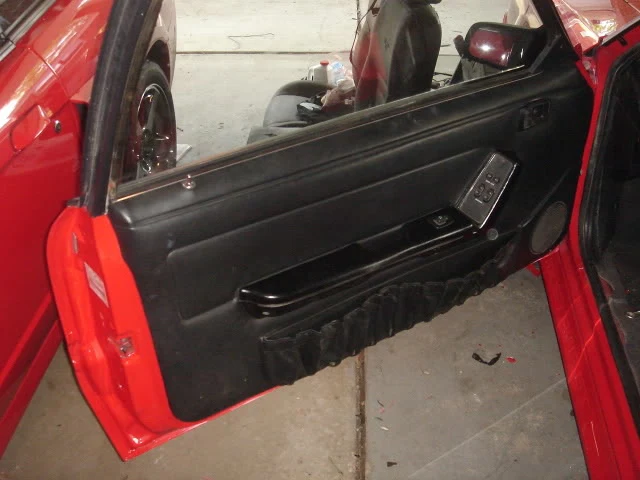

    Got both black door panels on. I had to paint the arm rests, but they look good.
    Got a little creative with the mirror switch. Didn't have to rewire it to the dash like in Hack Job....plus I couldn't becasue 94-98 defrost switch is under the headlight switch versus 99-04 being in the dash.

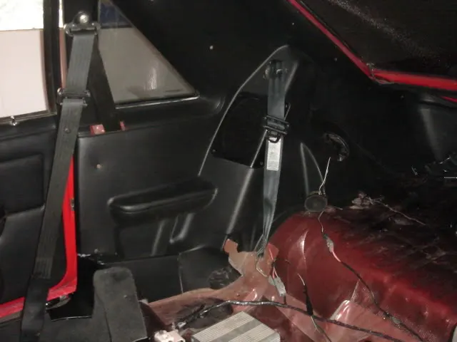

    Grey quarter trims painted black and installed. Black seat belts installed and working. Mach 460 Speakers working. Notice the tweeter hanging out of the shock cover??? I figured I'm cut a hole in those covers instead of ruining some nice quarter trims.

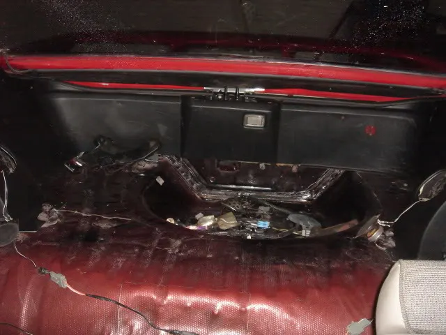

    Black hatch trim.

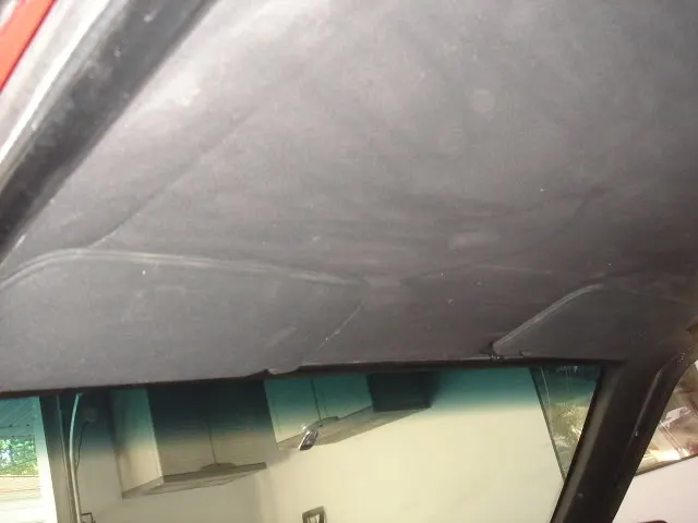

    Black visors and 93 black headliner. I'm using the 97 domelight cause I'm using the 97 harness. The 93 dome light won't work with that harness cause the ground congiguration is different and I'm not changing it over.

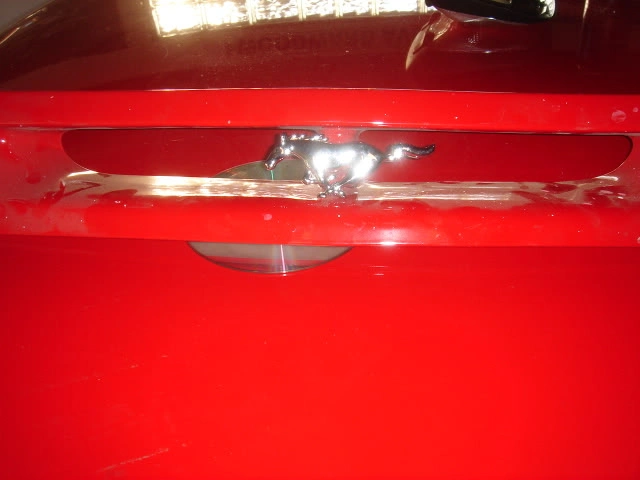

    Pony installed in the 93 Cobra grill. It's ready to get taped and screwed into the bumper....what a $hitty design, but oh well. :shrug:
