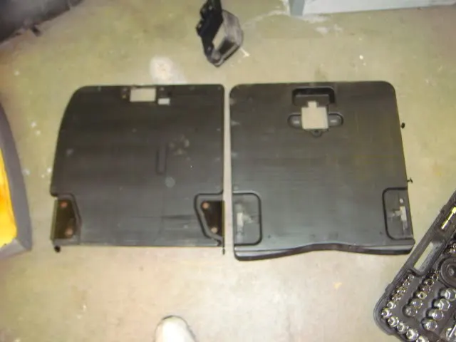

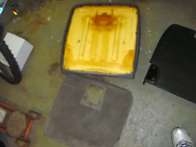

  9. Got the back seat conversion done. Dreaded this for a month, didn't work on the car. Why? It took a total of two hours from starting to dismantle the four seats to changing them over and install them in the car.

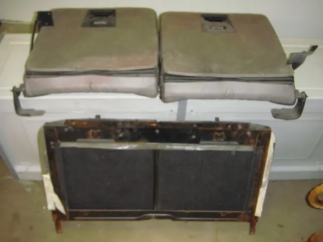

    94-04 backing inside of seat compared to fox body inside of seat. I simply slipped the older backings inside of the newer seats. No trimming necessary.
    Sucks to have to take apart nice fox body seats but oh well.

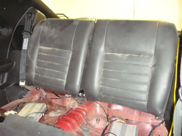

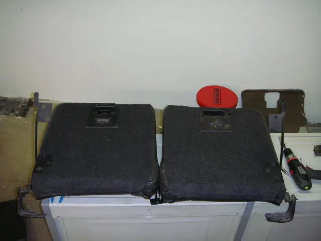

    94-04 style seats with fox body inserts inside, latching system and hinges.

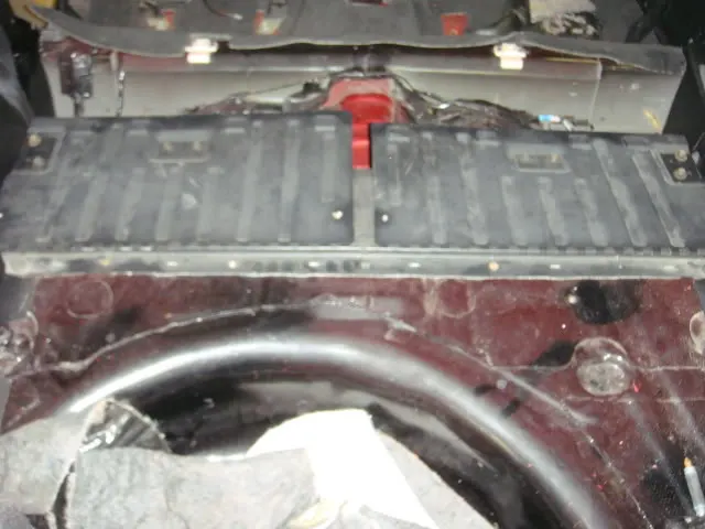

    Installed. The passenger side looks lower because the middle swing hinge (in the middle on the floor) wasn't bolted down all the way when I snapped the pic. They work perfectly.
