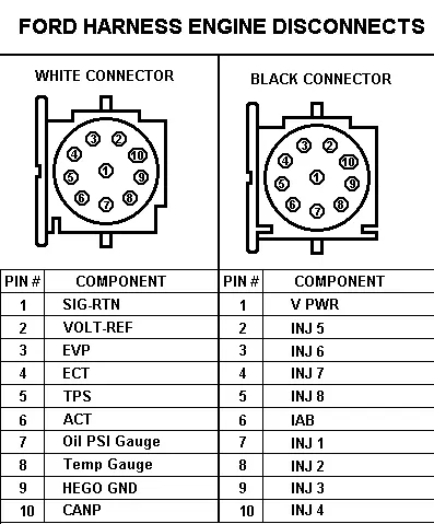

They have a lot to do with it. The injector harness and sensors all go through there:For example, my last Foxbody I believed had some connection issues with the 10 pins. The car was totaled before I had a chance to clean them up, which I believe was givimg me inconsistent and eradicate readings. How much of a role do the ten pins come into play with a new efi when I get a new Fox?
