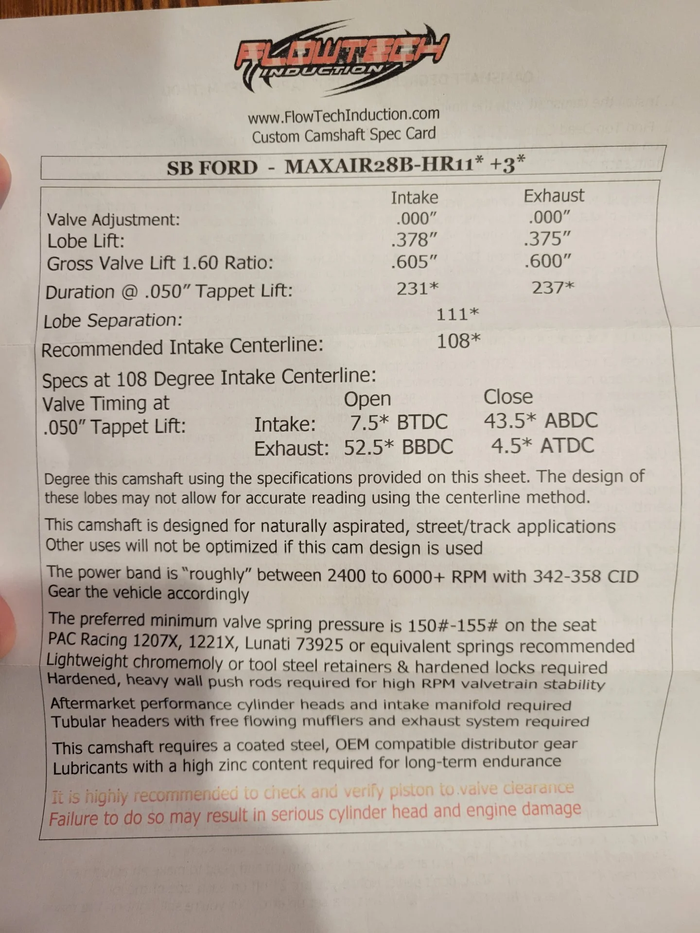

No.. just has a long exhaust duration.Is the cam damaged?
My springs are good to 750 lift.I have a hot custom cam from Ed that I never installed in my 347, as I found my fubar situation when I went to do the swap. I have no idea if it'll work in your setup, but I can grab a pic of the cam specs tomorrow. I had told him I wanted street manners, but still wanted to party. I know it's a touch over 600 lift though. Are your springs rated for that?

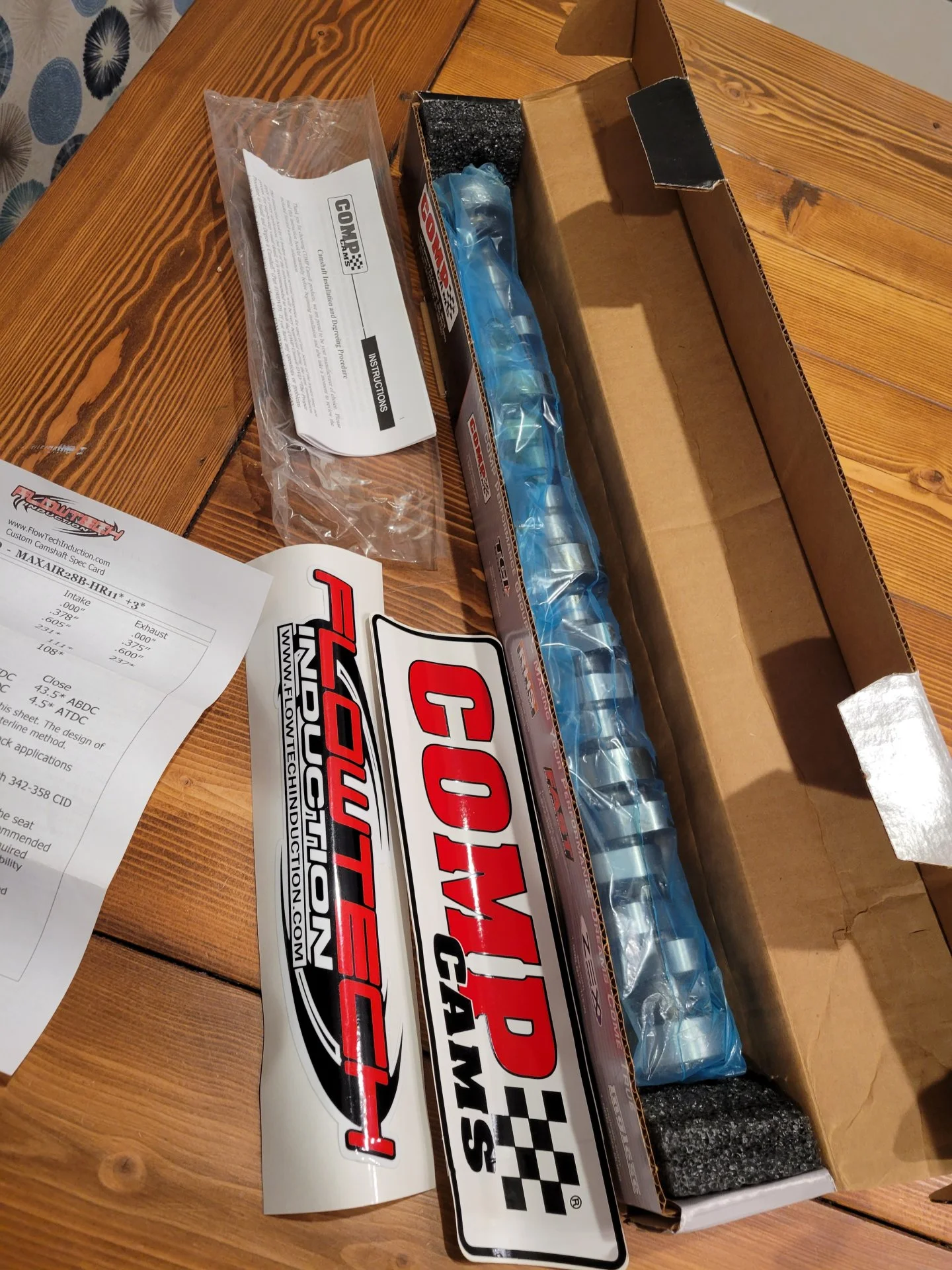

YesSorry man, completely forgot today, but can in the morning. Youre looking for a hydraulic roller cam, right?
I will take it... if nothing else if I have issues with the turbos I can always run it naturally aspirated.Sorry for taking so long. As I mentioned, I had this ground for my 347, and never ended up installing it. Not looking to get new money for it, id hook you up if you think its useful for your build.
