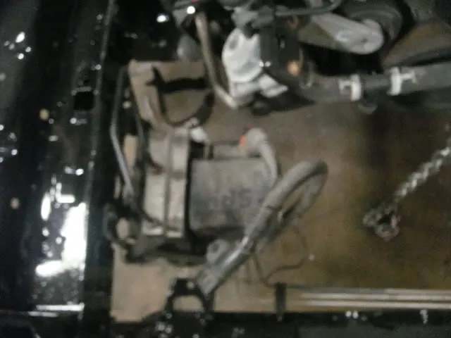

ABS with lines installed.

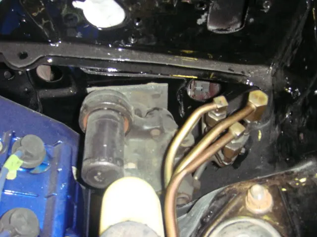

Hydroboost lines hooked up.

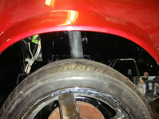

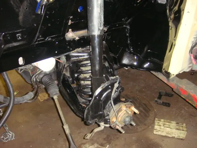

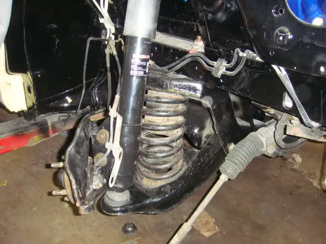

Half a coil cut from each spring. I used fox body V8 springs. I hope it's enough because they were still a PITA to install with that PITA internal spring compressor. Lowering springs drop in with NO spring compressor, should forked out the extra $230 bucks.
LH
suspension. 96-04 spindles, new Monroe Sensitrac struts, fox body V8 spring with 12 a coil cut.
RH
suspension. 96-04 spindles, new Monroe Sensitrac struts, fox body V8 spring with 1/2 a coil cut.

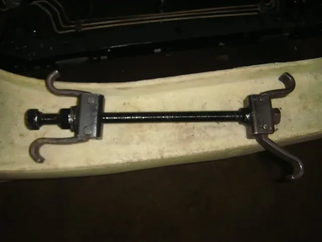

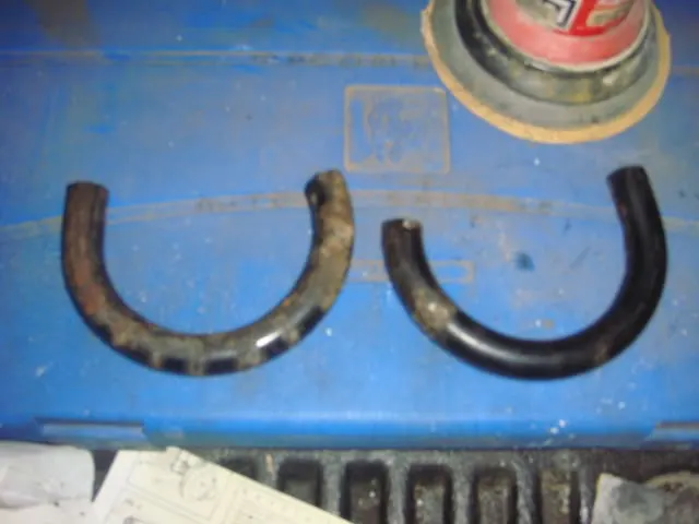

Spring compressor internal use only. This would scratch the crap outta your newly painted stock springs. Of course getting the parts of the tool out of the springs was fun. A big pry bar and a couple large screw drivers helped. Of course the once pretty
LCA's are now nicked and scratched up. LOL. But, this isn't a show car. This will be driven around a lot!
