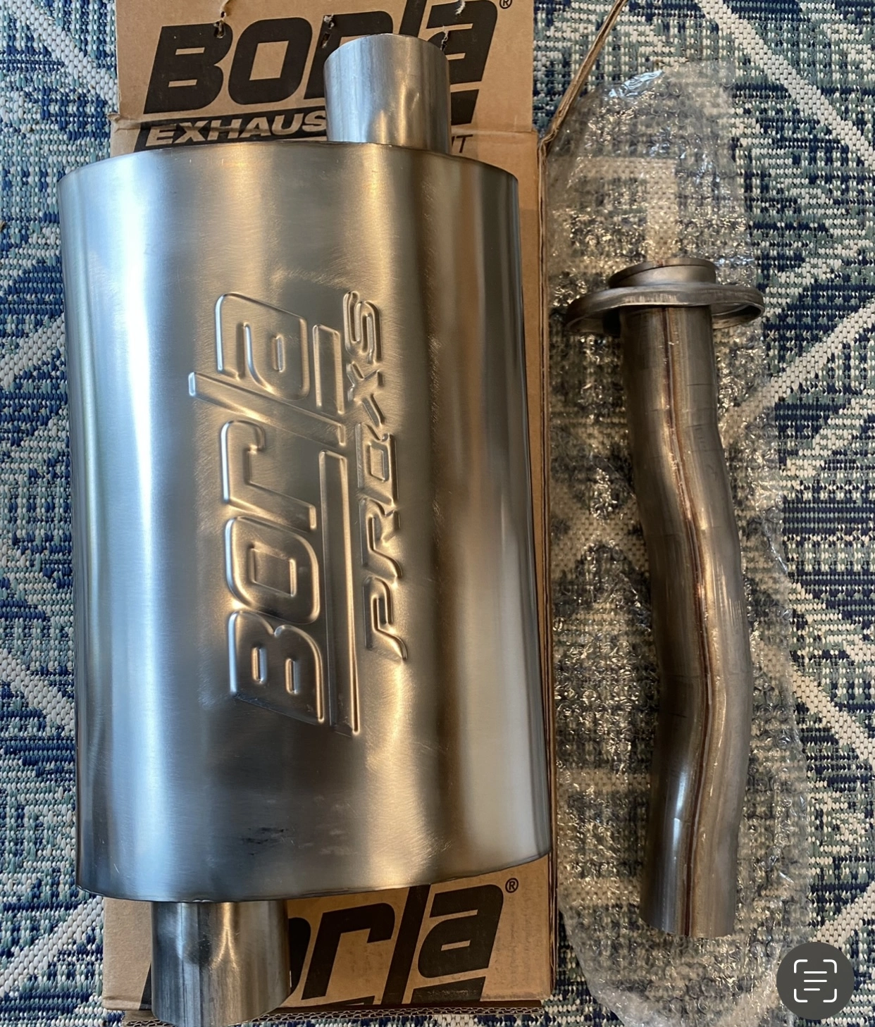

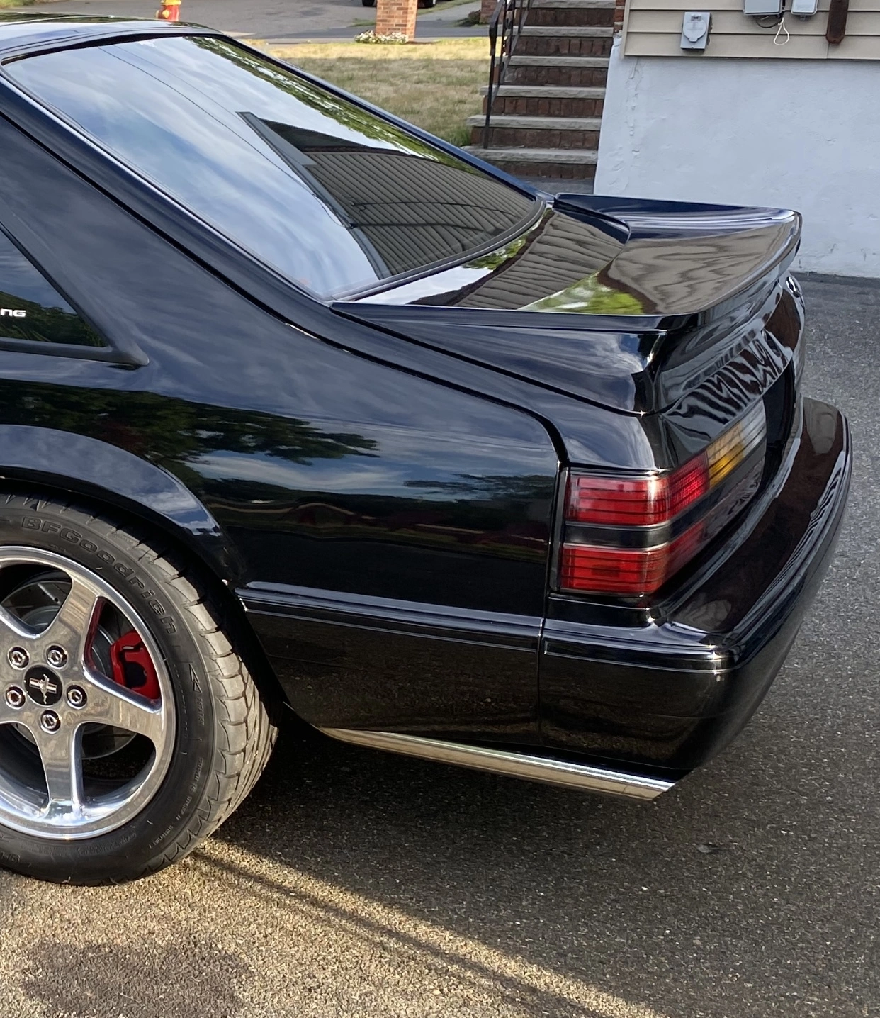

Pair of Borla Pro XS with Pypes flow tubes. All stainless, and pretty nice pieces.
I’ve sure you’ve heard my say I’ve wanted to quiet my car down a tad. These have a reputation of being quiet until you get on it. Also, might make some power switching from my chambered Flowmasters to this straight thru design.
My final debate is tailpipes. Do I try and salvage my 20* year old flowmaster tailpipes which are SS tips, but have an aluminumized section at the muffler; or buy a new set of tips?
I am going to install my panhard bar this fall, so the tailpipes need to clear that. I know the flowmaster tails clear, but need to be sure whatever I buy also clears.
Debate is really the LMR stainless tips or a new set of flowmaster stainless tips.

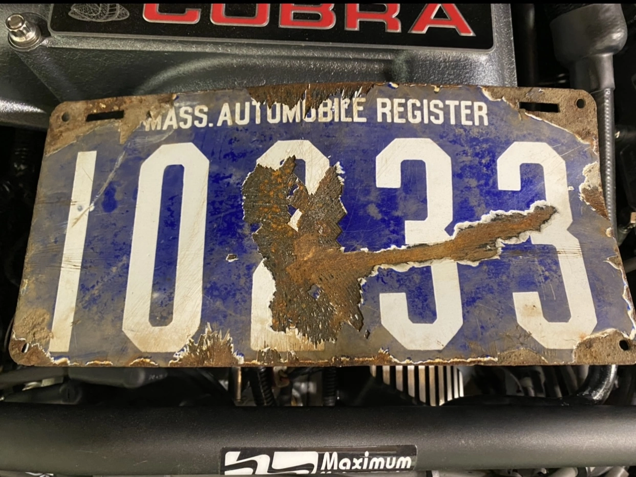

Also, I’m sure you folks have seen my collection of pre-1950 Massachusetts license plates on the wall.
My latest purchase. A 1905 plate. This was the 10k plates issued in MA, and likely one of the first 15k official govt-issue plate in the entire country.
A little beat up, but I don’t mind as this style plate in better shape is a $1k and up plate.

Mike, I spent about an hour the other day looking through pictures on lmr's website of the various tailpipes out there. I ended up with the SR performance tailpipes. I thought the pypes set up was pretty nice too, but I just like the look of the straight pipes more than the curved ones. I also hate those kinds that convert from polished tips to mild steel or whatever within View of anyone standing near the car.
Some reviews suggested that they had to do a little more cutting and rewelding to get the perfect alignment, but I had the same experience with a couple other pairs in my time. So, I guess that's just something we should expect to deal with.

Those were the ones I was looking at, along with these. I believe these clear the PHB as well. The SR ones and LMR ones are 304 SS apparently.
There is also these, which are 409 stainless.
I’d prefer 304 over 400-series
I would like to try and salvage my existing pipes. Gonna see if I can even get them out of the mufflers in a reusable way.

So, the LMR ones are the ones I put on Kandi a while back. <Build Thread Link> check out posts 34, 46 & 49.
I had a pretty talented muffler guy down the road with the ability to cut, bend his own pipes and weld everything in place while I stood there holding it exactly where I wanted it. They were also stainless and non-magnetic. So, if you've got the talent, then I encourage them, but if not, then maybe try for a set that is better shaped. I don't know if SR's are the way to go there, either. Like I said, I saw a complaint or two, but most loved 'em and I saw enough pics with them properly aligned (raked upward with body panel & stopped at the rear lower fascia) that I'm confident I will get it where I want it to be, even if they aren't perfect.
And... absolutely not for me on those flowmasters. The transition from polished to turd just pisses me off. Just maybe it's far enough back that I wouldn't normally see it, but not taking that risk.

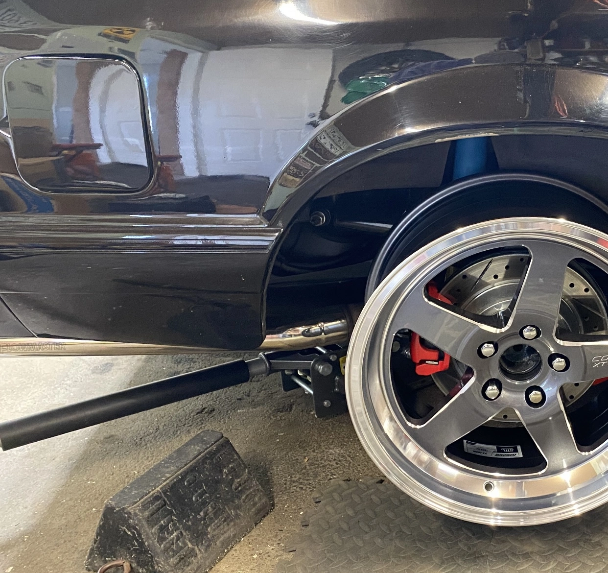

My existing flowmaster tips transition up behind the wheel. You can’t really tell.
I think whichever route I go, I’ll buy right before install just so I have the option of returning if they fit like junk.
Can’t really see the change since it’s behind the wheel and covered by the tire

I think the bigger issue is that they are 20 years old and pretty sure I clamped the hell out of them onto the mufflers.
We will have to see when we get closer.

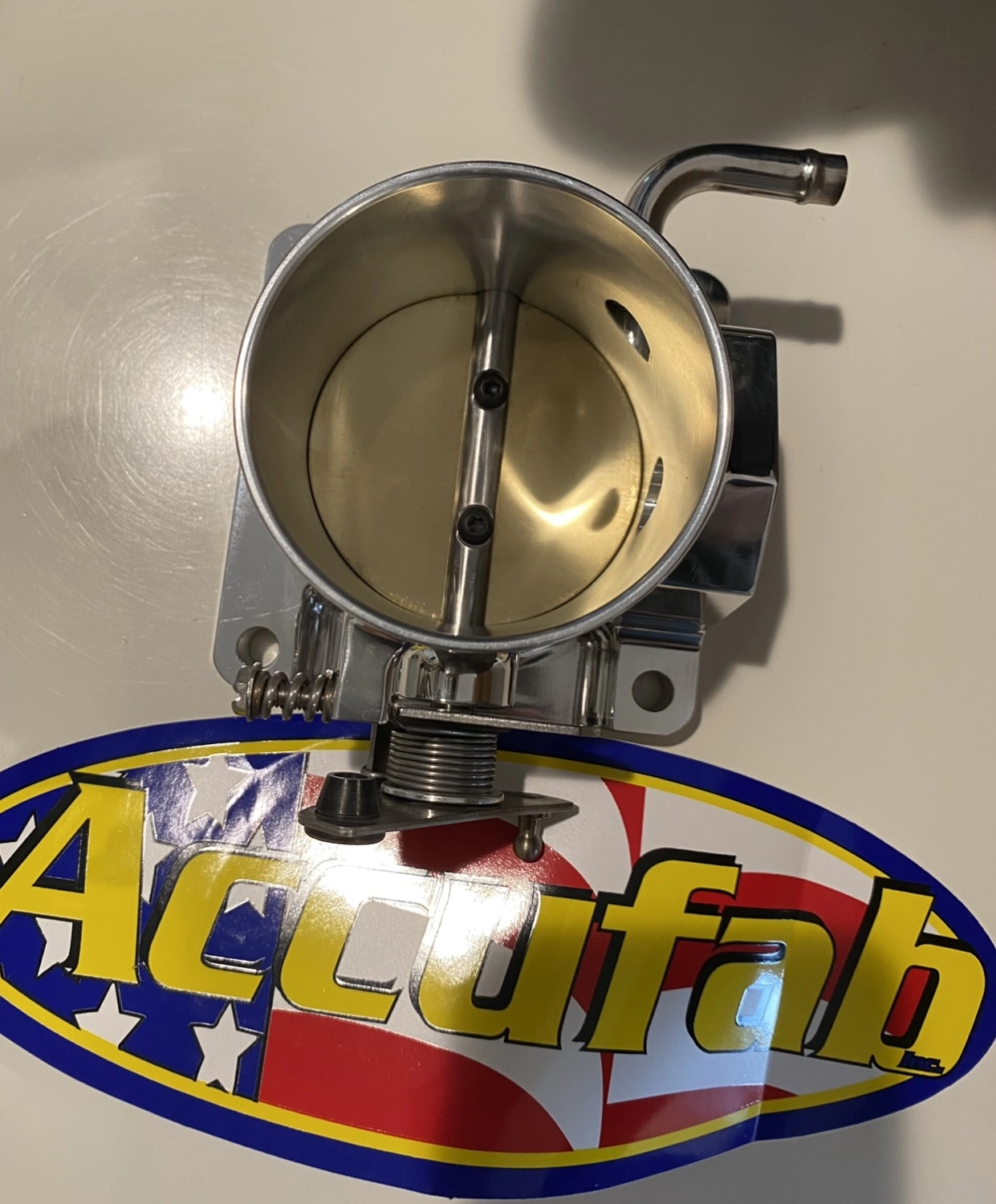

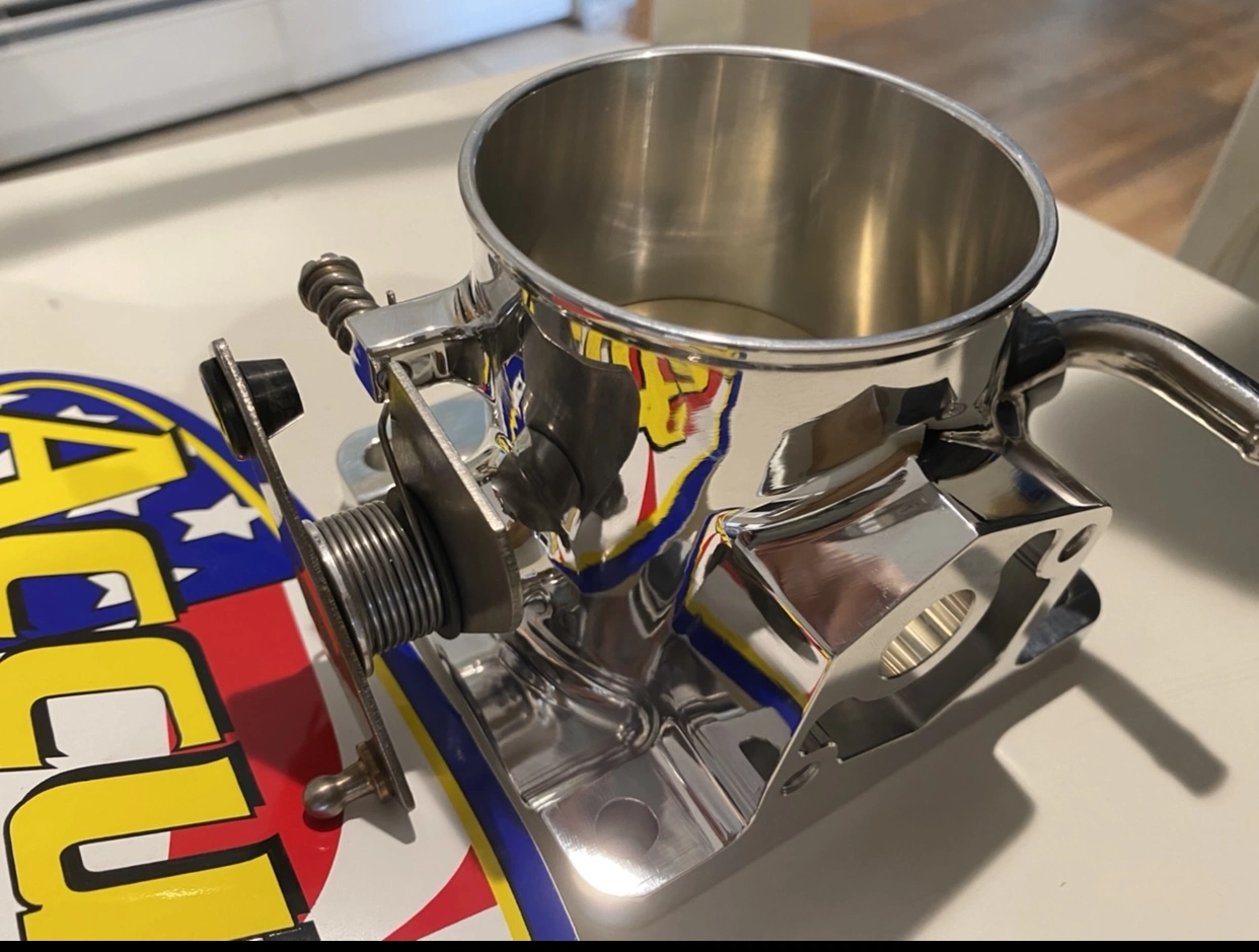

I did order an Accufab 70mm. I just wanted a nice, polished TB on the end of my intake. Should be here next week. Need to swap the 30# injectors on with the MS and I have decided to switch back to the 180 tstat. The Motorcraft 195 delays too much before opening so I always think I’m overheating. I preferred the characteristics of my old 180 stat better.
